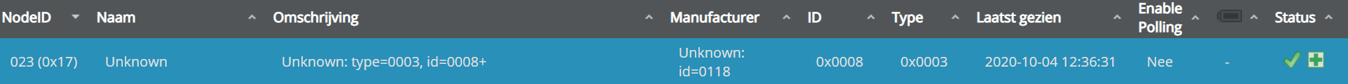

Including the TKB Home TZ67 was not easy, but now that it is included in Domoticz it shows as:
And in the Z Wave config:
Within the manufacturer_specific.xml the switch is there:
Also the tz67.xml is in the Config/wenzhou directory, but the device is not showing correctly within Domoticz.
Could this be because of the different ID's\Types? And if so, can and how can this be changed?
