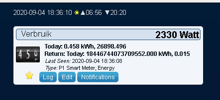

I have connected a serial to USB (FTDI) to my domoticz server since a year or so.
In the beginning the value for returned power (which is none existant) was 0 as it should be.
But since a half year or so, the value displays "18446744073709552.000 kWh, 0.015"
When I google "18446744073709552" I only find some errors about an overflow.
Power usage and logs are displayed normally.
I have had an RPI3 for the past year, I have played with it a lot so I thought I messed something up.
Viewed the database but no sign of errors.
Today I replaced the RPI with an old laptop, installed Ubuntu 20.04 and a fresh new installation of Domoticz.
Did not change any config, added the powermeter and immidiatly got the same problem.
Does anyone have a clue or tip for me to fix this?
Thank you in advance.

Domoticz looks like this: It is a DSMR 2.2 meter from 2012.

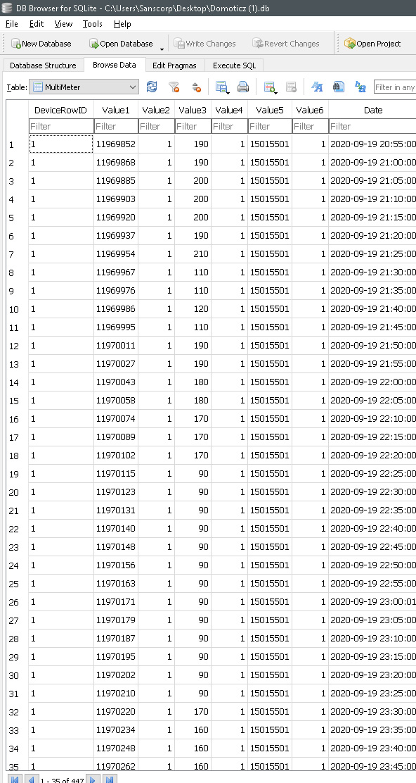

Device ID in domoticz is 2, but smart 2 or smart 1 says "Error: no such table: DeviceStatus"
Here is a screenshot of the DB: But it also happens with a complete new install.
Empty database, new added hardware and device, no other changes made to domoticz or system at all.
I have tried this on Raspberry Pi and Ubuntu 20.04 LTS server.

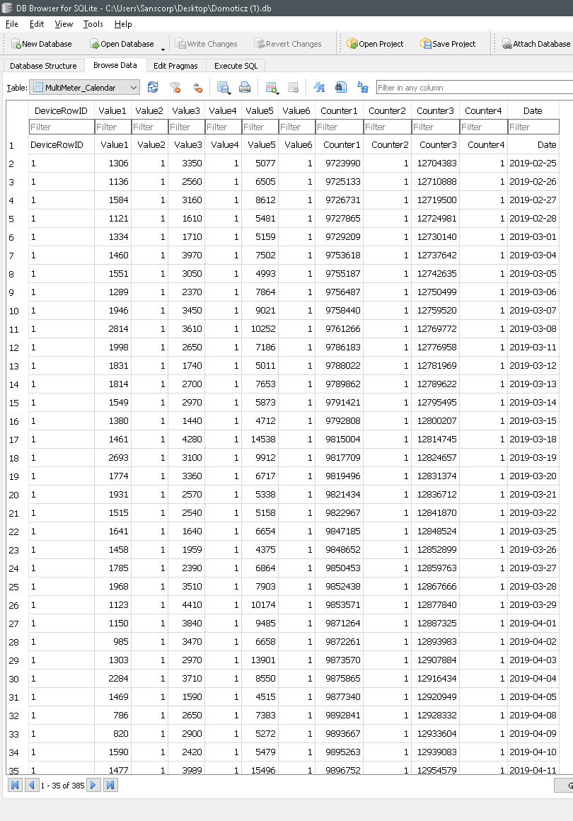

Here is MultiMeter_Calender.

Sorry but the screenshots do not help.sanscorp wrote: Monday 21 September 2020 13:54 Above query gives an error.
Did you change the directory and smartmeter id to the right values without spaces around the '=' ?
If you see "Error: no such table: DeviceStatus" you did not open the domoticz database

Data integrity check (downloaded backup, checked with DB Browser) does not give any error.
Which columb or table is for the 24h data?

table MultiMeter

Table Multimeter is filled from 23-09 till today.
