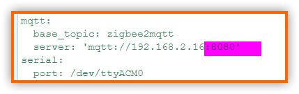

Hi Heggink,
thnx for your reply.
I have only 1 usb sstick on my pi 4.
dmseg gives port ttyACM0
this is in my configuration.yaml
homeassistant: false
permit_join: true
mqtt:
  base_topic: zigbee2mqtt
  server: 'mqtt://192.168.2.16:8080'
serial:
  port: /dev/ttyACM0
advanced:
  network_key:
    - 45
    - 102
    - 120
    - 132
    - 7
    - 230
    - 82
    - 195
    - 243
    - 187
    - 18
    - 202
    - 56
    - 6
    - 237
    - 183
salopette
Posts: 187
Joined: Tuesday 07 March 2017 21:03
Location: Germany
Re: Zigbee2MQTT
Post by salopette »
are you sure it is de port for mqtt?
Standard port is 1883
JuanUil
Posts: 500
Joined: Friday 22 May 2015 12:21
Domoticz version: 4.11083
Location: Asten NB Nederland
Re: Zigbee2MQTT
Post by JuanUil »
You are right, thnx but the problem persists
