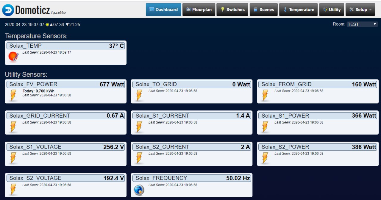

I have completed another plugin to integrate Solax FV inverter into domoticz
https://github.com/ayasystems/SolaxHTTP
Best regards and enjoy it
