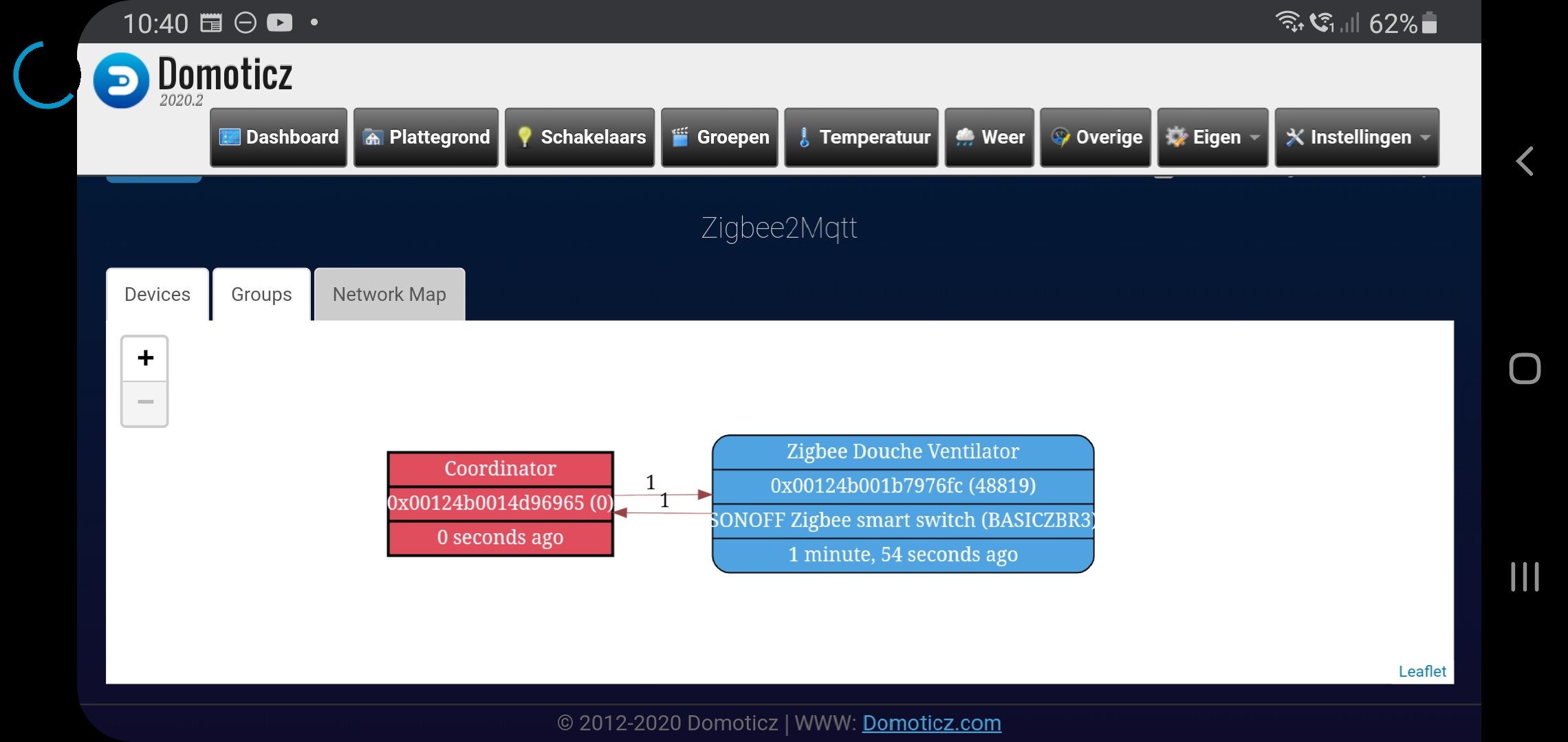

It shows this
EddyG
Posts: 1042
Re: Zigbee2mqtt rssi
Post by EddyG »
That is really bad. I have sometimes already have problems with a link-quality of 31.
That link-quality give a signal strength of 2 or 3 in Domoticz
What type of controller do you have and what is the distance.

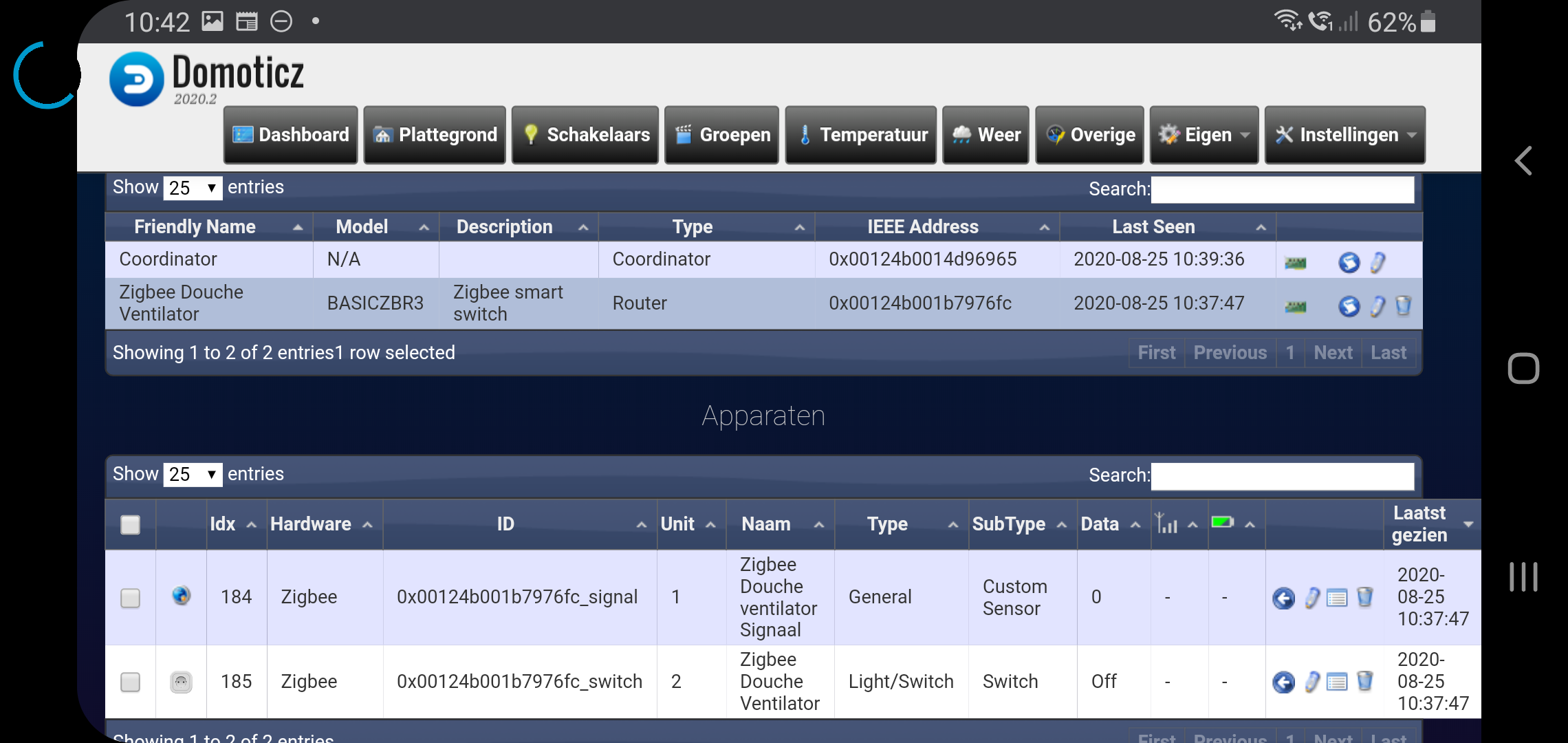

Okay I received my Mijia sensors and they have a great connection.
3x 170
1x 10
and the sonoff Baciszbr3 still at 0 which is 2 meters above a sensor that reads 170 signal strengt.
