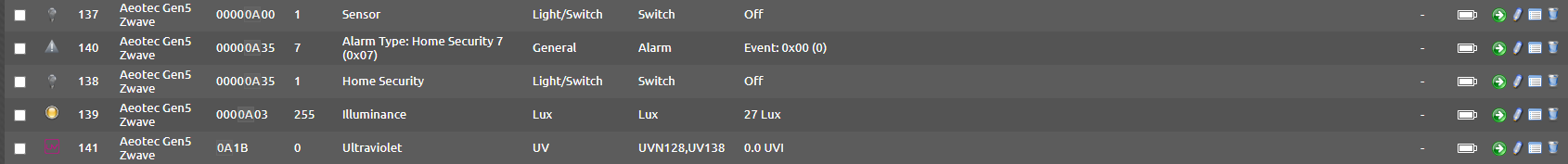

Today I have added the multisensor 6 to my domoticz system. (2020.2 on Pi4)
But I'm missing the temp and hum sensor? I have excluded and factory reset the sensor. But the same result after including the sensor again.
Does anyone know what's going wrong here?
Thnx.

When I installed those it took a while (hours) before all sensors showed up as devices, when running on battery.
The ones powered by USB was done in minutes (1-15?)
- Set system to accept new devices, not just for five minutes; I forget this almost every time I install new hardware..

Hi TSkar,
Thank you for you reply. It worked.
