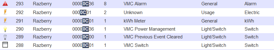

I want to connect the ZMNHCD1 to a 2 speeds exhaust fan unit(VMC in french). Because it was not working properly I connected 2 light-bulb to Q1 and Q2 to try to understand.
Domoticz recognize 6 devices:
I try to use for device 288:
- Blinds
- Blinds inverted
- ON/OFF (default)
It is only possible to switch the relay connected on I2 from domoticz. It is not possible to switch the relay I1.

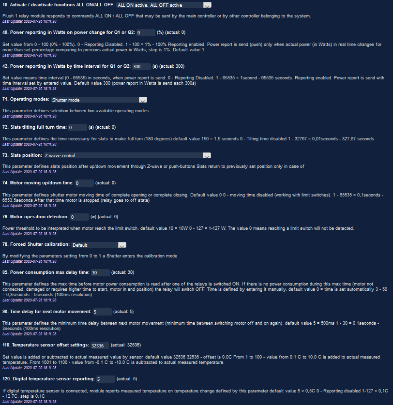

My conf :
10 : All on and All off
40 : 1
42 : 300
71 : Shutter
72 : 150
73 : Z-wave control,push button, or when limit is reached
74 : 0
76 : 50
78 : Default
85 : 20
90 : 1
110 : 32536
120 : 5
