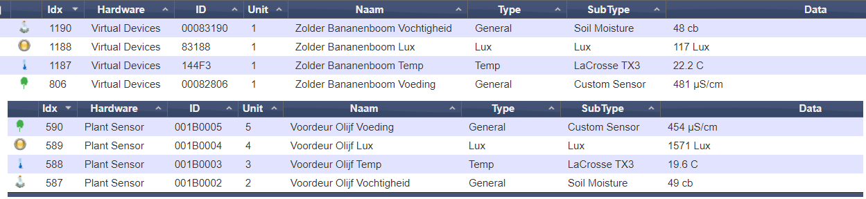

dheuts wrote: Monday 24 August 2020 9:34 Can you please help me how to make a script in dzVents so this works?
I already edited your script so it works for one of the sensors for the water. How to make this script working for all 4 plants and also the plant food sensors?
Happy to help but need some additional information.
Names, types and subtypes of all involved sensors
Per plant the water- and foodlimits to decide when notification is required.
That's a quick response! Thanks a lot!
If it's possible to make it for 2 sensors, I think I can do the rest myself?
Please check the sensor types, subtypes and names in the attachment below.
I would like notifications when next limits will be reached (for example the Bananenboom = Banana Tree)
Voeding <350 AND Vochtigheid <40: Bananenboom heeft voeding nodig
Vochtigheid <20: Bananenboom heeft water nodig
Thanks a lot!
