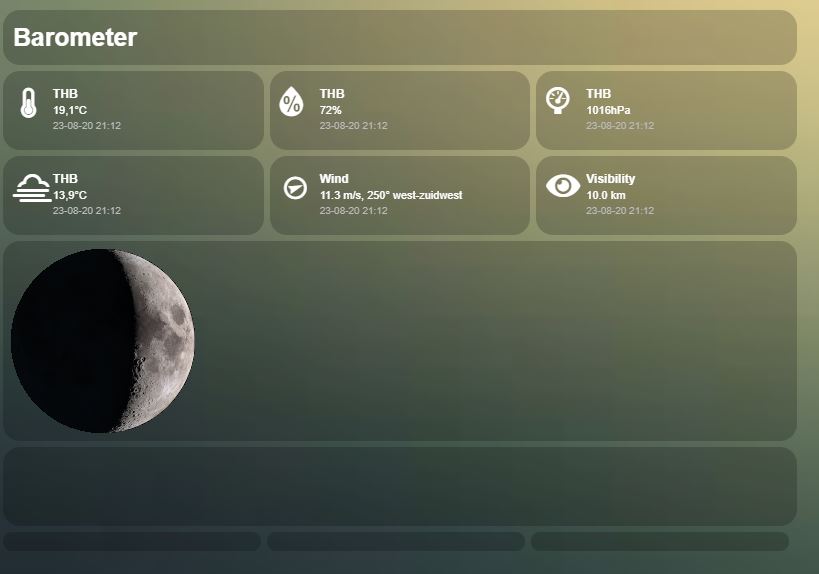

I'm working with the latest Dashticz V3.5-master. I cannot get open weather map working.
It is working in domoticz but just won't show in Dashticz. I used the fairly simple instructions from the manual
//Configuring the OWM parameters
config['owm_api'] = '7c4bd2526cc4b8ed811ddfead1a557c9';
config['owm_city'] = 'Mainaschaff';
config['owm_name'] = '';
config['owm_country'] = 'de';
config['owm_lang'] = 'nl';
config['owm_cnt'] = '3';
config['owm_min'] = true;
config['owm_days'] = true;
//Adding OWM to a column
columns[3] = {}
columns[3]['blocks'] = ['currentweather_big_owm','weather_owm']
columns[3]['width'] = 3;
I removed all extentions in Chome.
Any ideas?

found the problem
changed from V3.5 master to V3.5.2 beta and problem solved
git fetch origin
git checkout beta
git pull
