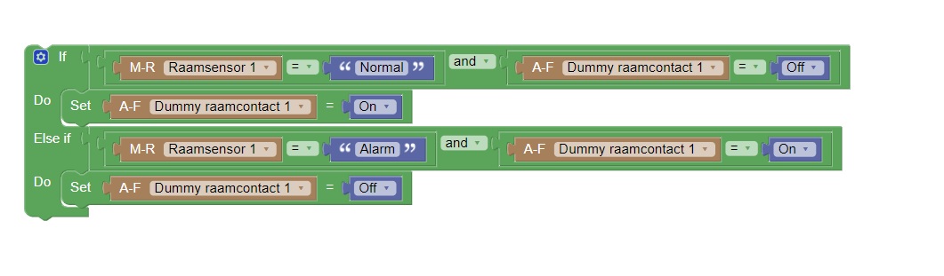

why does this one doesn't work?
i"m trying to trigger a dummy that shows the window is open or closed. Trying that with a Kerui D026 which has a 'normal' and 'alarm' status.
The Raamsensor 1 does its work. The dummy does not change status.

You probably need to change the alarm and normal values to text values, use the light green box option and type the status between the quotes like this:-

Thanks for your advice. It works for 50%. See my script. The Dummy light goes on when the sensor says "Normal", but does not turn off when status is "Alarm". Is "Alarm" maybe the wrong key word?
script raam.jpg (66.32 KiB) Viewed 1326 times

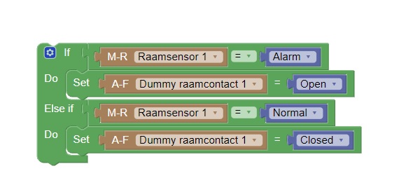

Found the problem. The "alarm' status is wrong. instead it listens to 'Open' and 'Normal'.
Works like a charm.
