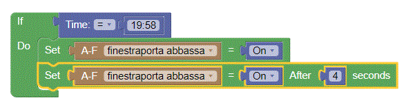

Hallo friend, sorry for my english... I have domoticz and sonoff dual and 4chpro to control roller shutter. I try to create an event to close partially by given 2 command to releè within few second but not work... what i wrong?
here my event
here my event
here my event
here my event

did you try on for 4 seconds?
How is the shutter connected in Domoticz?

ciao har0543 thank you for the answer! the 2 shutters are connect to domoticz by a sonoff 4ch pro R2 with the latest espurna fw. I tried for 4 seconds, and less but no work... so the sonoff seem no receive the 2' impuls to stop before the seconds pulse time set on sonoff switch.

Are you sure on is the right commando? Isn't it stop? When you want to stop it? How does it work when you do it manually?

Yes, "on" is the right command , exemple: when I use rf remote controller by rfbridge: I push 1 time to open the roller, and another time on after 3 seconds for stop it.

Hmm ok. And if you use a dummy momentary switch to activate the the roller.
Then you can try this by activate this once and again after 4 seconds. To make sure all commandos are right.

...friend but... a dummy momentary switch it's that i create to control sonoff 4chpro with domoticz... or not?...
