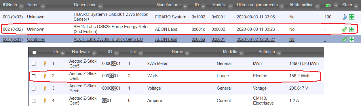

I assumed you energy meter is a smart meter. If you get this error it obviously is another type / subtype. Can you look at the devices tab to see what the device type and subtype of your energy meter is ?

Raspberry Pi 3 - Buster
Domoticz 2020.2
AEON Labs ZW090 Z-Stick Gen5 EU
AEON Labs DSB28 Home Energy Meter (2nd Edition)
Raspberry Pi 3 and Pi 4 - Pi Camera - DS18B20 - HC-SR501 - FGMS-001 - Telegram Bot
Re: Energy Meter and Notifications
Feybio wrote: Monday 03 August 2020 11:40 Raspberry Pi 3 - Buster
Domoticz 2020.2
Thx. Can you try with this one?
