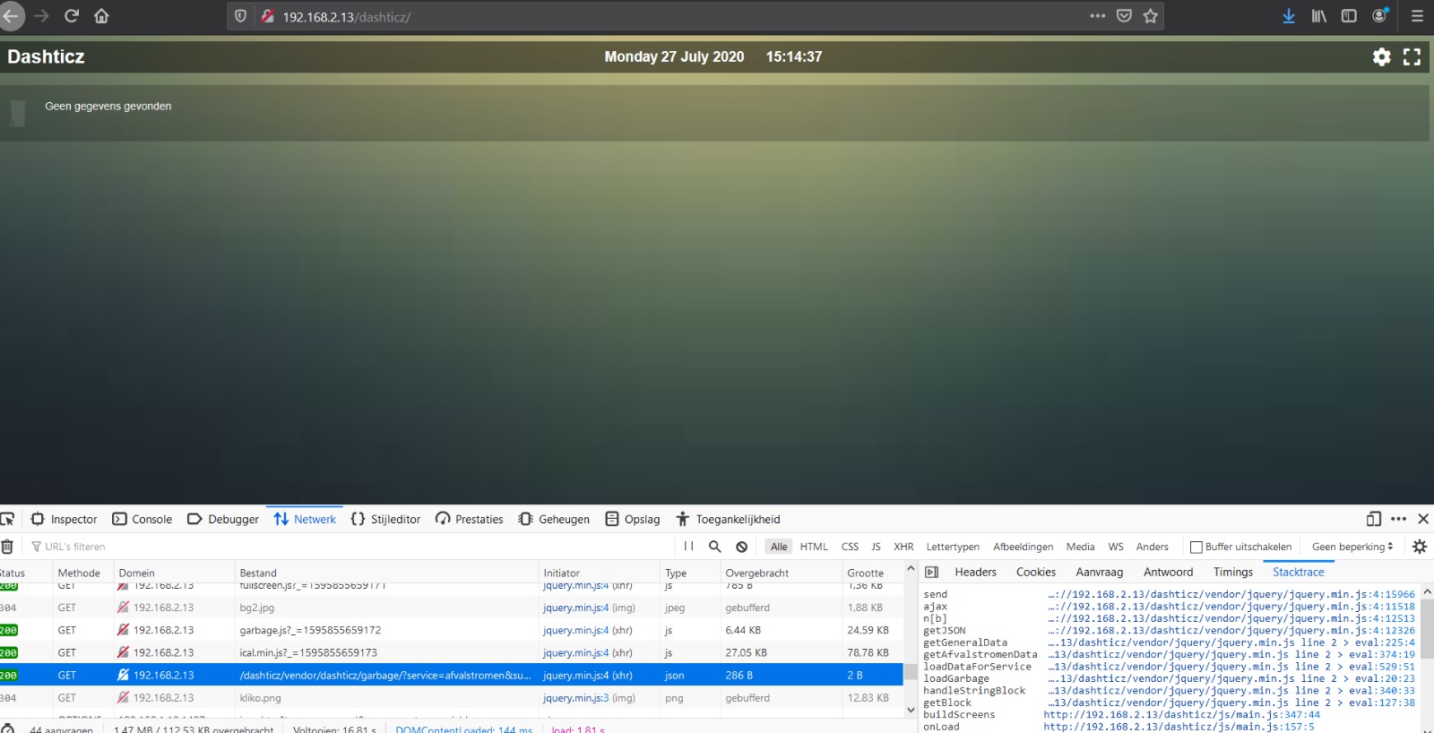

@mojojojo490
if i use your code for the garbage collector i get no result...
- garbage.JPG (12.19 KiB) Viewed 2825 times

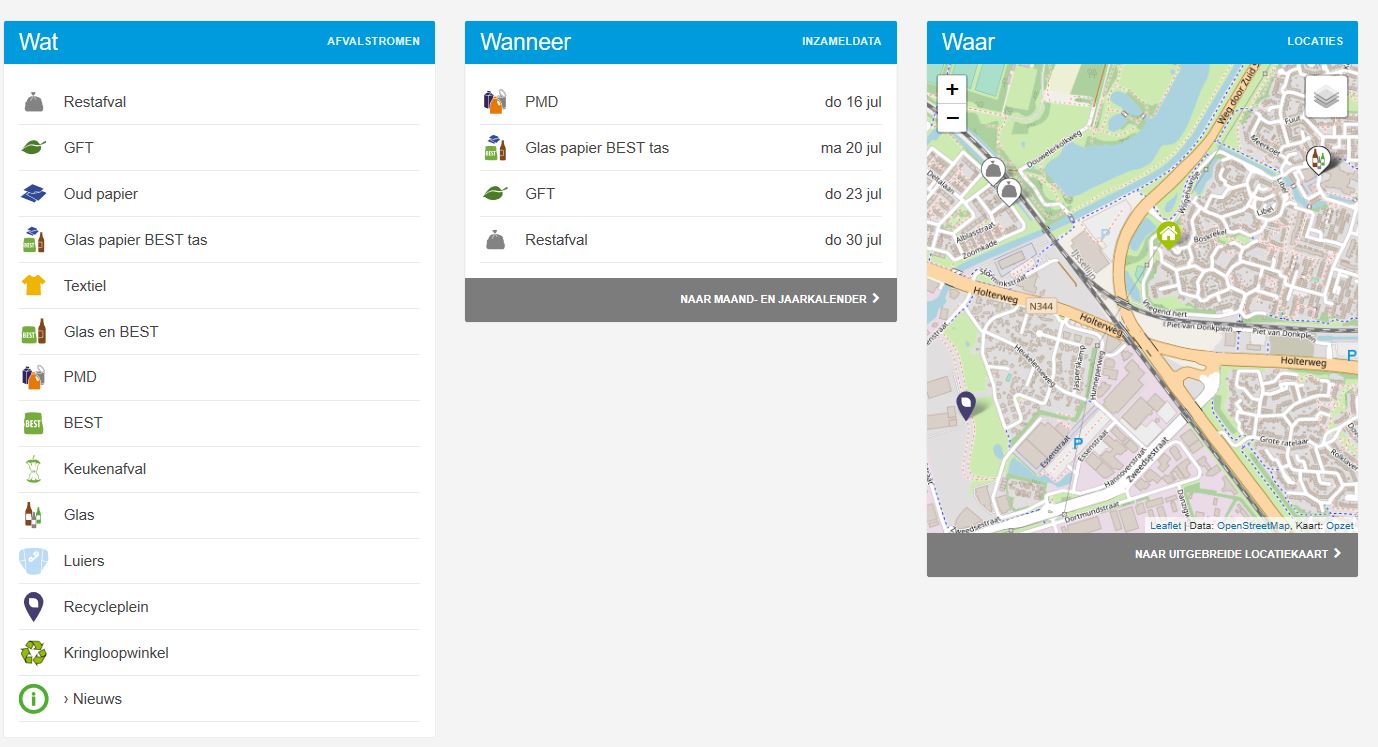

@NilsNijenhuis what do you see when you follow the link:
https://afvalkalender.circulus-berkel.nl/adres/7423GV:50Starter RPi3B, Domoticz Stable 2020.2, 10x Qubino Mini Dimmer, 1x Qubino shutter
Plugwise Anna + Adam + 2x Koen-4 & 1x Floor; SolarEdge SE3000H
Dashticz v3
Dashticz v3
NilsNijenhuis
- Posts: 81
- Joined: Friday 10 July 2020 22:56
Re: Dashticz - Module - Garbage collector
i see the picture below if i use the link on the laptop
- circulus berkel.JPG (115.66 KiB) Viewed 2758 times

Gentlemen, I am a little further where things go wrong with getting the garbage query from Circulus-Berkel, the one below between the "" is a response from a friend of mine who tested it on his NAS.
"Put it on the NAS at my company and it doesn't work there either. At the bottom right you can see that things are going wrong with getGeneralData (eval). Dashticz has its own twisted jquery.min.js file. If they used If I had a standard, I could have tried a different version. Now I can't do anything with it. "
Is there someone here from the developers who put the 'jquery.min.js' together and could see what goes wrong on line 224: 4 ????
- garbage fout in Json.jpg (201.58 KiB) Viewed 2705 times

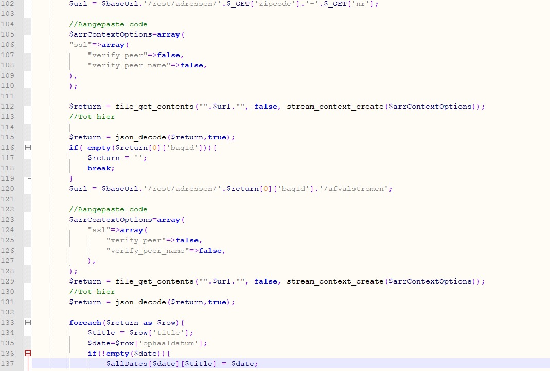

We found the sollution for a working garbage collector for Circulus-Berkel on the Synology NAS
In de map dashticz:
/vendor/dashticz/garbage/index.php -> you need to maken a adjustment in de index.php file.
see the attachment to get it work!!!
In de map dashticz:
- php bestand.jpg (113.06 KiB) Viewed 2669 times
Lokonli
- Posts: 2296
Great you found a solution!NilsNijenhuis wrote: Wednesday 29 July 2020 20:50 We found the sollution for a working garbage collector for Circulus-Berkel on the Synology NAS
In de map dashticz:
see the attachment to get it work!!!![]()
It seems that the SSL checks that are used for the https connection are not handled correctly on a synology NAS.
Can you double check that you enabled the php openssl extension on your Synology?
(I couldn't see it in one of your previous posts https://www.domoticz.com/forum/viewtopi ... 40#p252306.
Just want to be sure ...)
In your fix you disable the https address checking. It will not do too much harm, so I'll include your workaround in the next beta.
Again, thanks for finding this workaround!
