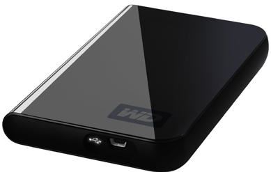

After malformed database error log yesterday it was time for me to say goodbye to SD cards. So, I made my RPi3 bootable from USB and copied the SD card to a portable "my passport Western Digital" USB 500Gb hard disk that I had laying around. For the copy process the DD command was used in Ubuntu Linux on my desktop.
