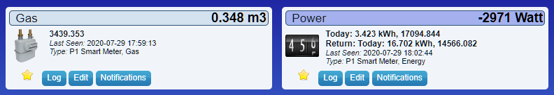

Below the devices in domoticz.
Re: Script to parse Electricity from P1 Smart Meter reading
DRB2019 wrote: Wednesday 29 July 2020 17:47 Below the devices in domoticz.
So if the devices are set to active on the devices tab, you should already see something like below in the utility tab. Is this what you want or do you want to see a split in the total high- and total low tariff ?
DRB2019
Posts: 24
Joined: Saturday 06 July 2019 13:59
Domoticz version: 4.10717
Post by DRB2019 »
I prefer to see the split in total high and low.
DRB2019 wrote: Wednesday 29 July 2020 18:17 I prefer to see the split in total high and low.
See below script. Explanation is in the comments of the script
