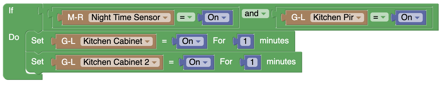

Hi..this works, but the timer doesn't restart each time there is movement..it does 1 minute then quickly turns off then back on again (assuming movement is constant). Got brain freeze on how to make it work...or maybe need to use a different option?

This is not possible with Blockly, you need to switch to dzvents for this to work.

Why do you use the timer? Just let the light switch on with movement. When the pir goes off again the light switches off. You can change the "on" time in the setting of the pir
