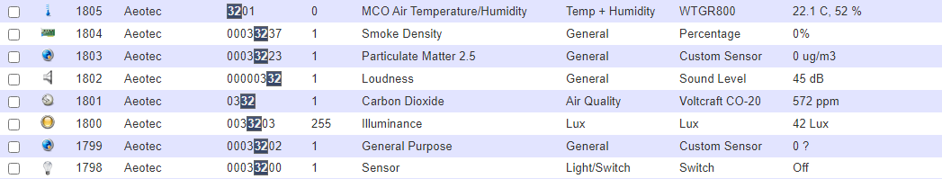

- VOC sensor doesn't show up in Domoticz; but it is in OpenZwave Control Panel.
- VOC sensor displays its value in the CO2 device (range 0.000 - 64.000)
- PIR sensor 0 or 1 as floating value. Result error in log:
(2021-04-07 15:36:00.902 Error: OpenZWave: Value_Changed: Unhandled value type ZDTYPE_SWITCH_NORMAL (2). Node: 5 (0x05), CommandClass: SENSOR MULTILEVEL, Label: General Purpose, Instance: 1, Index: 2 (OpenZWave.cpp:3189))

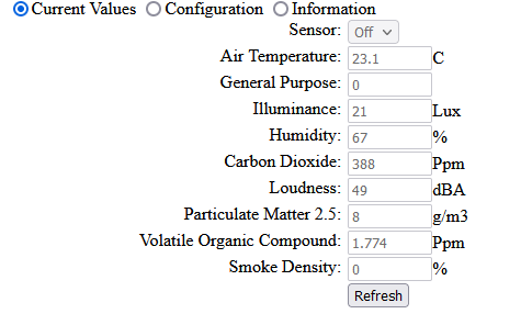

Here is some view from console and domoticz (is it the same for you?
Zwave devices console view
Domoticz devices
Domoticz devices
Have you more returns to do at this time?
