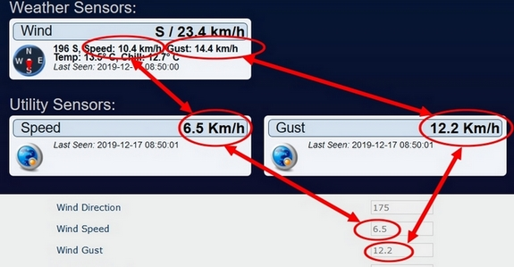

first thank you for this dzvents, I am a beginner domoticz and I installed the last version.
I have a little difference for the wind.
The speed are not the same in the different widgets compared to the livedata.htm page ????

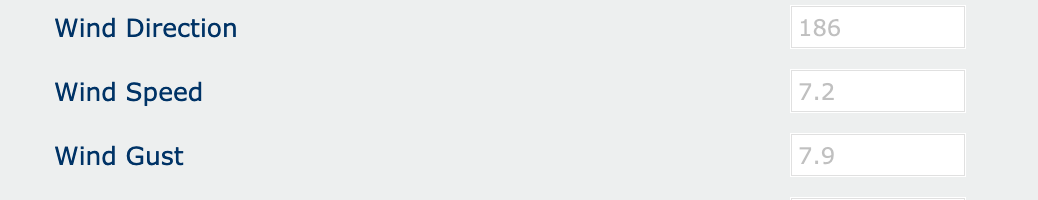

Wind is changing rapidly, it depends on the exact moment of measurment if livedata and the probe match ...
It almost matches here, the speed and direction changed in livedata while taking snapshots.
Screenshot 2019-12-17 at 11.05.11.png (23.26 KiB) Viewed 1614 times
Screenshot 2019-12-17 at 11.05.29.png (56.78 KiB) Viewed 1614 times
livedata changes almost every second while the dzevent probe runs every 5 min ...

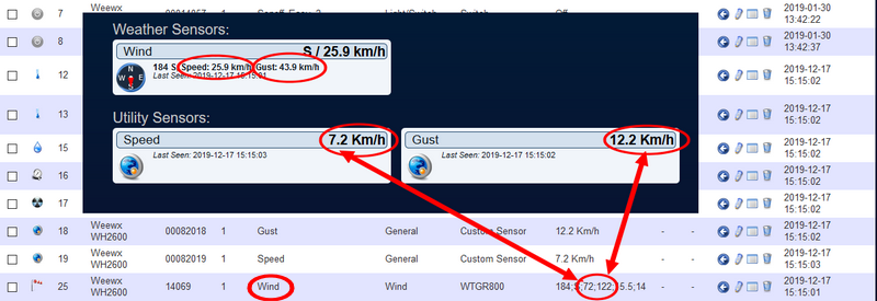

I have take the screenshots under 5 minutes and in 2 widgets custom sensor the data are good.
The all widgets has the same time.
A new sreenshot with widgets and devices, all data are good except Speed and Gust in Wind widget

Re: Get weather data from LAN based ObserverIP PWS
domopat24 wrote: Tuesday 17 December 2019 15:39 A new sreenshot with widgets and devices, all data are good except Speed and Gust in Wind widget
Can you please try and change the x-as of the windspeed and gust devices to m/sec as descibed in the comments of the script ?

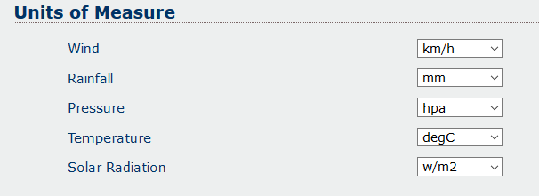

but the wind data in the weh page livedata.htm of my weatherstation are in Km/h, it is necessary to put m/s in weatherstation?
