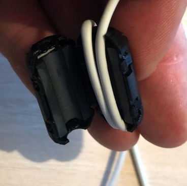

3. Ferrites are general 'suppression-devices' in my setups around the data-lines and at the power-entries to devices. Often very effectieve

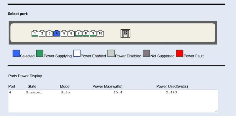

Its a bit more expensive in terms of time and money, but I use wired LAN PoE connections with PoE hats or converters. So power is doubly filtered by the LAN switch PSU and the PoE circuitry. If more protection were needed, I would run the switch from an UPS, device uptimes are completely dependent on the availability of the incoming mains, not its quality.
Headless Pi 3 Model B, no wifi or Bluetooth, drawing less than half an amp:

and in same segment ferrites for each device's entry point for data and for power: result is rather stable operation.
