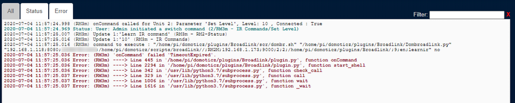

Debug: Python Only

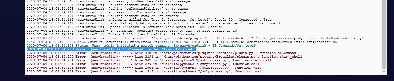

2020-07-04 11:57:24.998 (RM3m) onCommand called for Unit 2: Parameter 'Set Level', Level: 10 , Connected : True
2020-07-04 11:57:24.969 Status: User: Admin initiated a switch command (2/RM3m - IR Commands/Set Level)
2020-07-04 11:57:25.007 (RM3m) Update 1:'Learn IR command' (RM3m - RM2-Status)
2020-07-04 11:57:25.016 (RM3m) Update 1:'10' (RM3m - IR Commands)
2020-07-04 11:57:25.016 (RM3m) command to execute : "/home/pi/domoticz/plugins/Broadlink/scr/dombr.sh" "/home/pi/domoticz/plugins/Broadlink/Dombroadlink.py" "192.168.1.118;8080;24Dxxxxxxx;/home/pi/domoticz/scripts/broadlink//;RM2M;192.168.1.173;9000;2;2;/home/pi/domoticz/plugins/Broadlink/;9;en;learnir" no
2020-07-04 11:57:25.036 Error: (RM3m) 'onCommand' failed 'TimeoutExpired'.
2020-07-04 11:57:25.036 Error: (RM3m) ----> Line 445 in '/home/pi/domoticz/plugins/Broadlink/plugin.py', function onCommand
2020-07-04 11:57:25.036 Error: (RM3m) ----> Line 2294 in '/home/pi/domoticz/plugins/Broadlink/plugin.py', function start_shell
2020-07-04 11:57:25.036 Error: (RM3m) ----> Line 342 in '/usr/lib/python3.7/subprocess.py', function check_call
2020-07-04 11:57:25.037 Error: (RM3m) ----> Line 329 in '/usr/lib/python3.7/subprocess.py', function call
2020-07-04 11:57:25.037 Error: (RM3m) ----> Line 1006 in '/usr/lib/python3.7/subprocess.py', function wait
2020-07-04 11:57:25.037 Error: (RM3m) ----> Line 1616 in '/usr/lib/python3.7/subprocess.py', function _wait

zak45
Posts: 954
Domoticz version: V2024.4
Re: Python Plugin : Broadlink
Post by zak45 »
great!
this execute the right command.
verify that dombr.sh can be executed ( +x ) (ls -altr)
chmod +x if necessary...
you can run it by yourself if you open term session...
go to Broadlink folder:

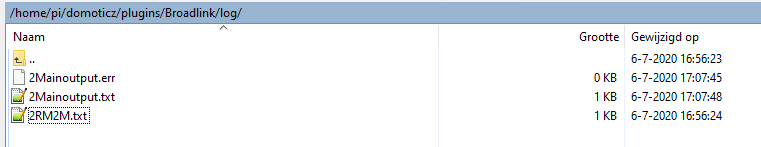

2Mainoutput.txt:
--------------------------------------Start-------------------------------------
STEP ==: learnir --- 2020-07-06 17:07:45
Connected to Broadlink device: 192.168.1.173
File "/home/pi/domoticz/plugins/Broadlink/Dombroadlink.py", line 407, in learnir
device.enter_learning()
File "/usr/lib/python3.7/broadlink/__init__.py", line 615, in enter_learning
check_error(response[0x22:0x24])
File "/usr/lib/python3.7/broadlink/exceptions.py", line 97, in check_error
raise exception(error_code)
broadlink.exceptions.StorageError: The device storage is full
Not able to enter learning mode
Error : <class 'broadlink.exceptions.StorageError'> The device storage is full <traceback object at 0xb5770c
88>
---------------------------------------END--------------------------------------
2Mainoutput.err: Empty file
2RM2M.txt:
0x2712 192.168.1.173 24Dxxxxxxxxx
zak45

2RM2M.txt:
Looks like problem with the broadlink library for your device ( suppose RM3 mini )

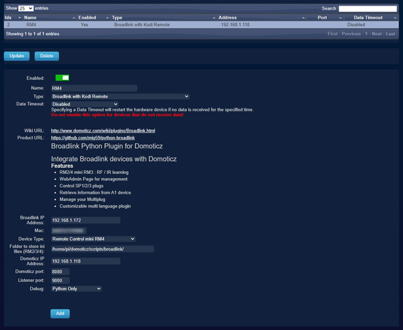

Manual I can trigger to learn code, do you think the cause could be that device (rm4c_mini, 0x62be) is missing in Dombroadlink.py file?
(Possible solution mentioned in https://github.com/home-assistant/core/issues/35875 is the need to specify the correct type in the config. Use type: rm4c_mini...)

you said that your device is a rm4c_mini
but you have a RM2M fle in your log directory with this code on it: 0x2712
this is for the RM2 / RM3 device.
Can you change your plugin settings and select Remote control mini RM4 ?

RM4c mini:
RM4
# broadlink_cli --type 0x62be --host 192.168.1.172 --mac xxxx31a7df24
Device file data (to be used with --device @filename in broadlink_cli) :
0x62be 192.168.1.172 xxxx31a7df24
temperature = 0.0

Ok. no problem.
For the RM3:
looks like your is part of the broadlink bug, maybe see if you can upgrade the firmware (do not know how to do that, I have a RM2 only)
For the RM4:
you have been able to learn manually, so this should work with the plugin.
Put the right settings (RM4) and IP (.172) /mac on the plugin, restart and test.
Let us know.

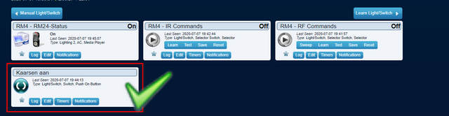

zak45, You are a genius! Thank you for your patience.
After reinstall setup.py it worked.

2020-07-07 19:44:13.704 (RM4) Generate "ON" Command for learned code stored on unit/ini : 10
2020-07-07 19:44:13.706 (RM4) Code loaded : 260058000001249511151016101611151016111511151039113811391039103912381039113812141115113910151214123810161016101610391115103910391115123810391039110005100001254d10000c4f0001254c10000d050000000000000000000000000000
2020-07-07 19:44:13.706 (RM4) b'&\x00X\x00\x00\x01$\x95\x11\x15\x10\x16\x10\x16\x11\x15\x10\x16\x11\x15\x11\x15\x109\x118\x119\x109\x109\x128\x109\x118\x12\x14\x11\x15\x119\x10\x15\x12\x14\x128\x10\x16\x10\x16\x10\x16\x109\x11\x15\x109\x109\x11\x15\x128\x109\x109\x11\x00\x05\x10\x00\x01%M\x10\x00\x0cO\x00\x01%L\x10\x00\r\x05\x00\x00\x00\x00\x00\x00\x00\x00\x00\x00\x00\x00\x00\x00'
2020-07-07 19:44:13.734 (RM4) Code sent....
2020-07-07 19:44:13.744 (RM4) Update 1:'On-1' (Kaarsen aan)
2020-07-07 19:44:13.678 Status: User: Admin initiated a switch command (4/Kaarsen aan/On)
2020-07-07 19:44:52.766 (RM4) Device not modified by plugin
