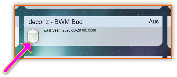

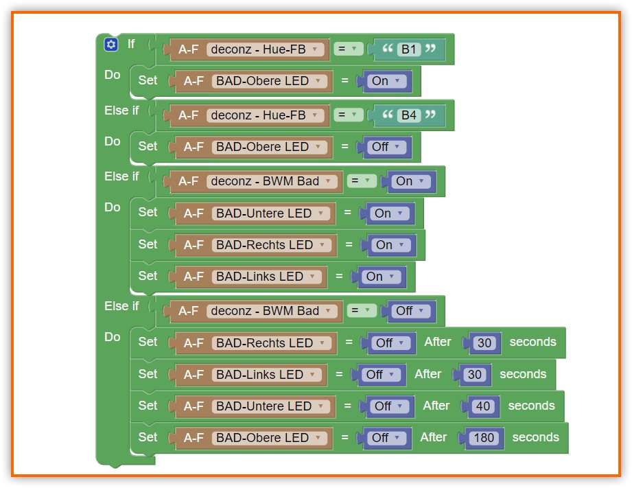

@Thorgal789
I was behaving strangely in the log of Domoticz.
If I e.g. other switches / sensors from Deconz appear in the log.
But they have nothing to do with the circuit.
Are also not used in the Blokly script.

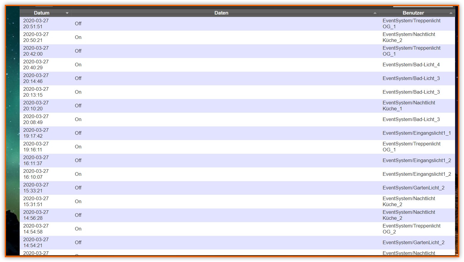

That when I look at the protocol from the motion detector.
I only mentioned it because lately the lights have not been switched off properly or not at all.
If someone leaves the bathroom, it should be off after 30-40 seconds, but it doesn't always happen.
I have in sonoff with tasmota and hue motion.

I don't have the "Benutzer" part on my log ... It's not because you have enabled some log in domoticz (I had same when enable dzevent logging) ?
Your script seem good for me.
The only problem I m seeing is if you press a button in same time the sensor go to "off", you will trigger the first or second "if" so you can't reach the 4th to turn off bulb, ybut you realy need to be unlucky to have this situation.
The 4 "lights" stay "on" or only some of them ?

I have now deactivated DzVents log, and created 2 different scripts, one for movement and one for switch.
Let's see what happens next!

I could not test it today because it is only home in the evening.
All lights remained on, so only the 3 that were switched via motion
