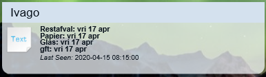

Post by iTDB »
Set /etc/ssl/openssl.cnf to MinProtocol = TLSv1.0
* reboot
And It works!
pi@raspbian:~/domoticz/logs $ ls -l
total 68
-rw-r----- 1 root root 13390 Apr  7 18:21 garbagecalendar_m_ophaalkalender-be.data
-rw-r----- 1 root root  3946 Apr  7 18:21 garbagecalendar_run_m_ophaalkalender-be.log
-rw-r----- 1 root root  3856 Apr  7 18:21 garbagecalendar_run_update_m_ophaalkalender-be.log
-rw-r----- 1 root root 43747 Apr  7 18:21 garbagecalendar_web_m_ophaalkalender-be.log
[b]pi@raspbian:~/domoticz/logs[/b] $ sudo cat garbagecalendar_run_m_ophaalkalender-be.log
@GarbageCal(m_ophaalkalender-be): #### Tue Apr  7 18:21:00 2020 ### Start garbagecalendar script v20200406-2030
@GarbageCal(m_ophaalkalender-be): #### Debuging dataload each cycle in the foreground because "testdataload=true" in garbagecalendarconfig.lua
@GarbageCal(m_ophaalkalender-be): ####    please change it back to "testdataload=false" when done testing to avoid growing a big domoticz log and slowing down the event system.
@GarbageCal(m_ophaalkalender-be): #### Debuging with extra messages because "mydebug=true" in garbagecalendarconfig.lua
@GarbageCal(m_ophaalkalender-be): ####    please change it back to "mydebug=false" when done testing to avoid growing a big domoticz log.
@GarbageCal(m_ophaalkalender-be): domoticzjsonpath: /home/pi/domoticz/scripts/lua/
@GarbageCal(m_ophaalkalender-be): datafilepath: /home/pi/domoticz/logs/
@GarbageCal(m_ophaalkalender-be): scriptpath: /home/pi/domoticz/scripts/lua/
@GarbageCal(m_ophaalkalender-be): Loaded /home/pi/domoticz/scripts/lua/garbagecalendar/garbagecalendarconfig.lua.
@GarbageCal(m_ophaalkalender-be): Loaded /home/pi/domoticz/scripts/lua/garbagecalendar/tablefuncs.lua.
@GarbageCal(m_ophaalkalender-be): start foreground webupdate for module m_ophaalkalender-be of file /home/pi/domoticz/logs/garbagecalendar_m_ophaalkalender-be.data
@GarbageCal(m_ophaalkalender-be): lua /home/pi/domoticz/scripts/lua/garbagecalendar/m_ophaalkalender-be.lua "/home/pi/domoticz/scripts/lua/" "9000" "59" "" "/home/pi/domoticz/logs/garbagecalendar_m_ophaalkalender-be.data" "/home/pi/domoticz/logs/garbagecalendar_web_m_ophaalkalender-be.log" "" "Pintelaan"
@GarbageCal(m_ophaalkalender-be): Start checking garbagetype_cfg table:
@GarbageCal(m_ophaalkalender-be): Glas change to glas
@GarbageCal(m_ophaalkalender-be): Restafval change to restafval
@GarbageCal(m_ophaalkalender-be): -> NotificationTime:19:22  Garbagetype:papier
@GarbageCal(m_ophaalkalender-be): -> NotificationTime:19:22  Garbagetype:gft
@GarbageCal(m_ophaalkalender-be): -> NotificationTime:19:22  Garbagetype:restafval
@GarbageCal(m_ophaalkalender-be): -> NotificationTime:19:22  Garbagetype:pmd
@GarbageCal(m_ophaalkalender-be): -> NotificationTime:19:22  Garbagetype:glas
@GarbageCal(m_ophaalkalender-be): -> NotificationTime:2:30  Garbagetype:reloaddata
@GarbageCal(m_ophaalkalender-be): -> NotificationTime:2:31  Garbagetype:dummy1
@GarbageCal(m_ophaalkalender-be): Start update for text device:
@GarbageCal(m_ophaalkalender-be): - Start looping through data from the website: /home/pi/domoticz/logs/garbagecalendar_m_ophaalkalender-be.data
==> GarbageDate:2020-04-10 GarbageType:pmd  Notify: Active=on  Time=19:22   DaysBefore=1   reminder=0   Calc Days Diff=3
==> GarbageDate:2020-04-10 GarbageType:restafval  Notify: Active=nil  Time=19:22   DaysBefore=1   reminder=0   Calc Days Diff=3
==> GarbageDate:2020-04-17 GarbageType:p-k  Notify: Active=nil  Time=0:0   DaysBefore=0   reminder=0   Calc Days Diff=10
@GarbageCal(m_ophaalkalender-be): - End  -----------------
@GarbageCal(m_ophaalkalender-be): #### Warning: These records are missing in your garbagecalendarconfig.lua file, so no notifications will be send!
@GarbageCal(m_ophaalkalender-be): #### -- start -- Add these records into the garbagetype_cfg table and adapt the schedule and text info to your needs :
   ["p-k"]                              ={hour=19,min=02,daysbefore=1,reminder=0,text="p-k"},
   ["grof huisvuil afroep"]             ={hour=19,min=02,daysbefore=1,reminder=0,text="grof huisvuil afroep"},
   ["kerstboom"]                        ={hour=19,min=02,daysbefore=1,reminder=0,text="kerstboom"},
@GarbageCal(m_ophaalkalender-be): #### -- end ----------------------------
@GarbageCal(m_ophaalkalender-be): ==> found schedule:pmd: vri 10 apr ; Restafval: vri 10 apr ; p-k: vri 17 apr ;
@GarbageCal(m_ophaalkalender-be): No updated text for TxtDevice.
@GarbageCal(m_ophaalkalender-be): #### 18:21:00 End garbagecalendar script v20200406-2030

I see that GFT is in my calendar when I have not entered it.
How can you hide unwanted garbage?
jvdz
Posts: 2441
Domoticz version: 4.107
Re: GarbageCalendar (new version) lua scripts
Post by jvdz »
iTDB wrote: Wednesday 15 April 2020 13:05 [I see that GFT is in my calendar when I have not entered it.
Not sure I understand your question. All GarbageTypes shown in the calendar are found in the Data from the Website and you will get only notifications for the GarbageTypes you have defined in the configfile in the garbagetype_cfg table.
So what are you exactly expecting/wanting it to do, since GarbageType GFT is definitely in your WebData.
Jos
iTDB
Posts: 29
Joined: Friday 29 November 2019 18:01
Domoticz version: Stable
Location: Gent
Post by iTDB »
jvdz wrote: Wednesday 15 April 2020 13:19 So what are you exactly expecting/wanting it to do, since GarbageType GFT is definitely in your WebData.
Jos
Is it possible to filter out the GFT and only show the Restafval, Papier, Glas
This is what it shows
2020-04-15 13_29_20.png (37.75 KiB) Viewed 1943 times

What about I modify the "active" option in the config table to the below and add the skip option? :
   -- active     ==> (optional)  default="on"
   --           active="on"   Both will show in Domoticz Text Device and Send notifications
   --           active="off"  Will show in Domoticz Text Device but not send notifications
   --           active="skip" Will not show in Domoticz Text Device and not send notifications
[code]
Jos
jvdz
Posts: 2441
Post by jvdz »
jvdz wrote: Wednesday 15 April 2020 14:38
This is now implemented in the current GitHub version. Just add the active field to the "garbagetype_cfg" GFT record like this:
   ["gft"]        ={hour=17,min=59,daysbefore=1,reminder=4,text="gft",active="skip"},
Jos

Thx. Works
