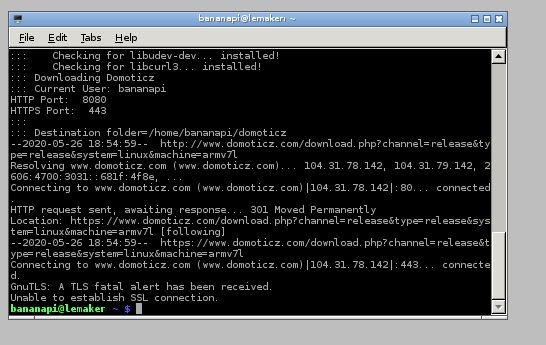

I've made recently a mistake on my BPI pro with my OS jessie: domoticz showed an update green icon to update ...and I've unfortunately clicked on this icon....result was Domoticz doesn't start anymore...of course i've made no back-up :cry:
Anyway I've reinstalled OS Jessie (took me 2 days...) on my BPI and now I can't install domoticz:
I try to install domoticz with:
curl -L install.domoticz.com \ sudo bash
then I have:
GnuTLS: A TLS fatal alert has been received
Unable to establish SSL connection
See joined image...
Can somebody help my to re install domoticz?
Thanks a lot!

CCL54 wrote: Tuesday 26 May 2020 19:03 Can somebody help my to re install domoticz?
Current release ( V2020.2) and latest Beta for Linux type systems only work on Buster.

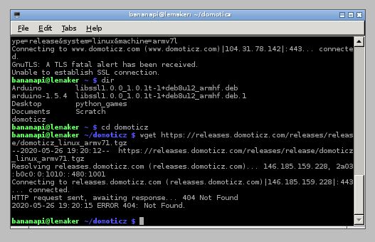

I also try to install an old version of Domoticz:
https://www.domoticz.com/wiki/Going_bac ... us_version
and I've this problem: 404 not found, see picture.
What I'am doing wrong?

I finally found my mistake:
The command :
wget https://releases.domoticz.com/releases/ ... armv71.tgz
doesn't work because before the . it's not a 1 but a l !
Correct command is:
wget https://releases.domoticz.com/releases/ ... armv7l.tgz

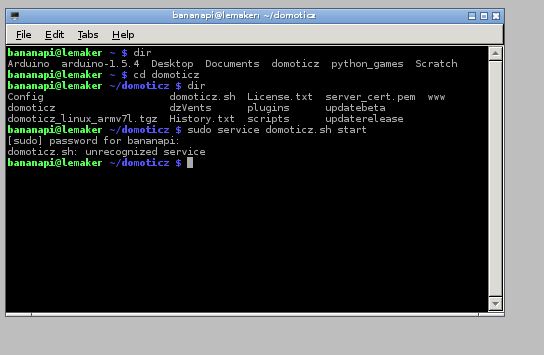

Now I extract tgz fllowing the procedure here:
with:
tar xvfz domoticz_linux_armv7l.tgz)
After reboot, no domoticz...even with sudo service start: it tell me "domoticz.sh unrecongnized service" see picture.
Any idea?
Thanks a lot.

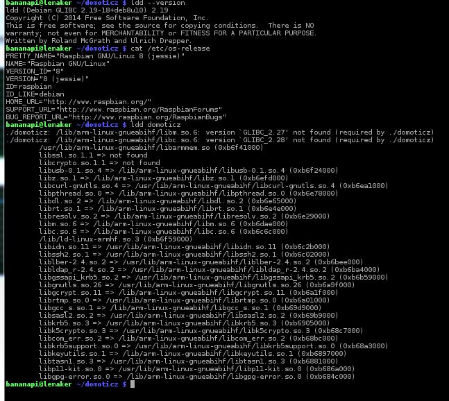

Additionnal information:
I think the problem is I have not all librairies, I've made ./domoticz, several librairies are not found (the famous libssl.so.1.1.0) and others...
see joined picture.
I tried to update libssl with
wget http://security.debian.org/debian-secur ... _armhf.deb
But no results domoticz doesn't start.
How I can revover my domoticz?
Please help
Thanks.

answere is here
after wget you need to use dpkg command https://raspberrypi.stackexchange.com/a/105859
