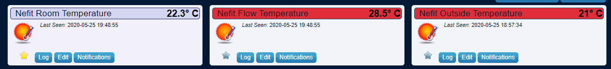

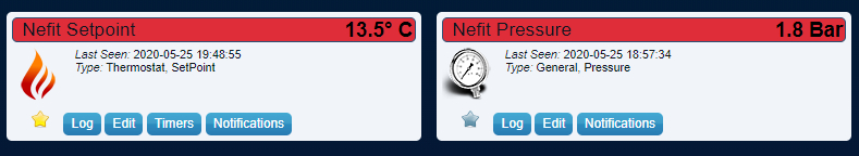

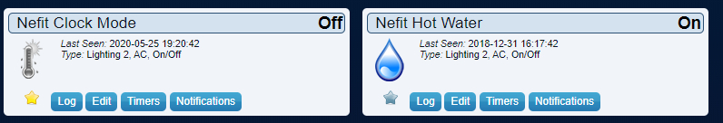

uh, I thought it worked at least...all the data showed up in domoticz, but when I tried to change the mode or set the temperature, nothing happened.
After that the data in domoticz also didn't update anymore, I actually saw the network get lost for a few seconds on the Easy.
In the log I see error setting user mode, then error setting setpoint, and after that continuous error getting http data, and also 1 time error CheckAuthToken - session ID not found.

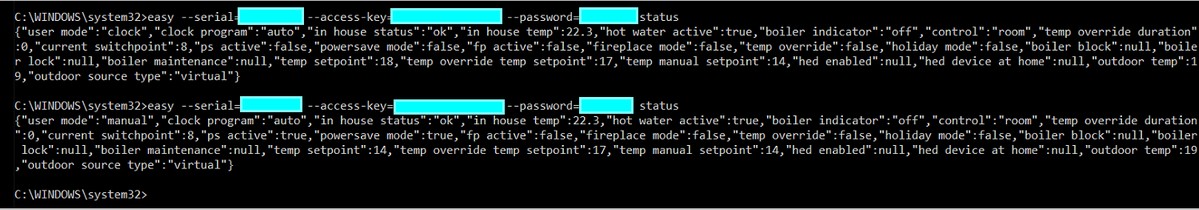

I have no flow, I just only see the data. It worked when I started the server and connected to it, when I tried to change the mode and setpoint it lost connection and never came back. That is in domoticz, because when I ask for status in windows it just shows fine and also updates.

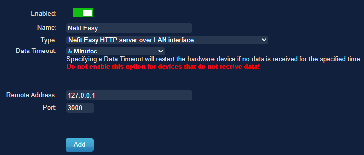

inside domoticz I used to have a flow that switched off heating when my alarm went in away mode, but that flow is not active yet. I just want to be able to see my temperature, and change the mode and preset temperature.

I don't think, you should set a data time-out. Just disable.
Not necessary, before it works perfect.

I initially didn't have a timeout set, but I just tried to see if this helped. But I will browse the mentioned post some more.
I just don't understand that it worked (as far as reading data) until I tried to write something and thereafter nothing seems to work anymore.
It seems to be in domoticz since directly checking state inside windows works fine.

I think the problem is that it doesn't know the password when setting, normally in pi I use the export commands, and after that all commands work without having to enter the password again. But I have no idea how to do this in node JS. All commands directly from within windows work just fine.
