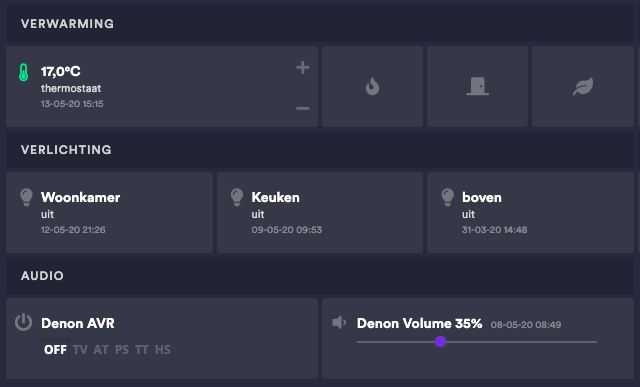

Hi! I've just started with domoticz & dashticz about a week ago, and really like it.
Sorry to bump this. I've been trying for days to figure out a way to change the heating.png image to an icon, without success. So i was glad that i found this thread.
I've tried changing it to an other image file as suggested, but that doesn't seem to work.
Has there been any progress with this feature? Or might there be some sort of workaround to override the default image for this block?

What is the device type for which you want to change the image? Also the thermostat device?

Yes, the image for my Nest, with class .iconheating, which is set to heating.png..

It should be implemented in latest beta, at least for a generic thermostat device. Can you check with your Nest?

Lokonli wrote: Friday 10 April 2020 17:48 It should be implemented in latest beta, at least for a generic thermostat device. Can you check with your Nest?
Sorry, i've been busy with other things than my dashboard lately, so my reply is a little late. Still use my dash daily though, and yes, it works like a charm. Thanks for implementhing the fix!
