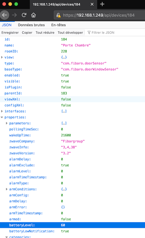

I’m trying to query a door sensor managed by my Fibaro HC3. I need to get the ‘batteryLevel” parameter in my Domoticz installation.
With a web browser, I successfully query the HC3 API and display the device’s informations :
Screenshot 2020-05-09 at 17.59.36.png (139.64 KiB) Viewed 3073 times
Please note the browser is asking me to authenticate to perform the query. I guess this might be the problem in my LUA.

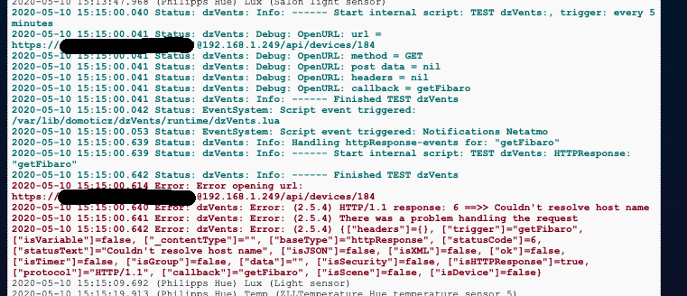

I quickly added the dzVents before leaving the house. I made sure of the prerequisites you mentioned.
This is what I have :
Screenshot 2020-05-10 at 15.18.52.png (176.35 KiB) Viewed 3062 times
I made sure I could ping the IP address from Domoticz : OK
I'm not quite sure why it's trying to resolve host name ? The IP address should be enough ?
I'll have a look later today. I'll try to create a DNS record maybe.
Anyway, thanks again for your help :)
