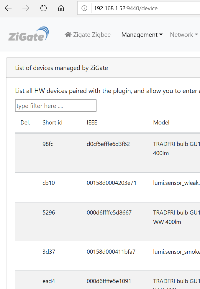

About the device-management tab in de Zigate webUI: For some reason I do not see the garbage-bin shaped button to delete devices. It was there some time ago. I tried to make the column broader, but that is not possible (I can make it smaller). Language change also not helping.
I want to use the button to delete a device. I deleted it from Domoticz, but somehow it still is in the devicelist of Zigate (I restarted the plugin already).

The Trash icon, will only be available if the entry can be removed.
If you don't get the Trash icon after a plugin restart, this is normaly due to the fact that some Widget remains connected to this entry

Sorry, you were right, it was still in my Domoticz devices list (had only set it to inactive). Now working again.
