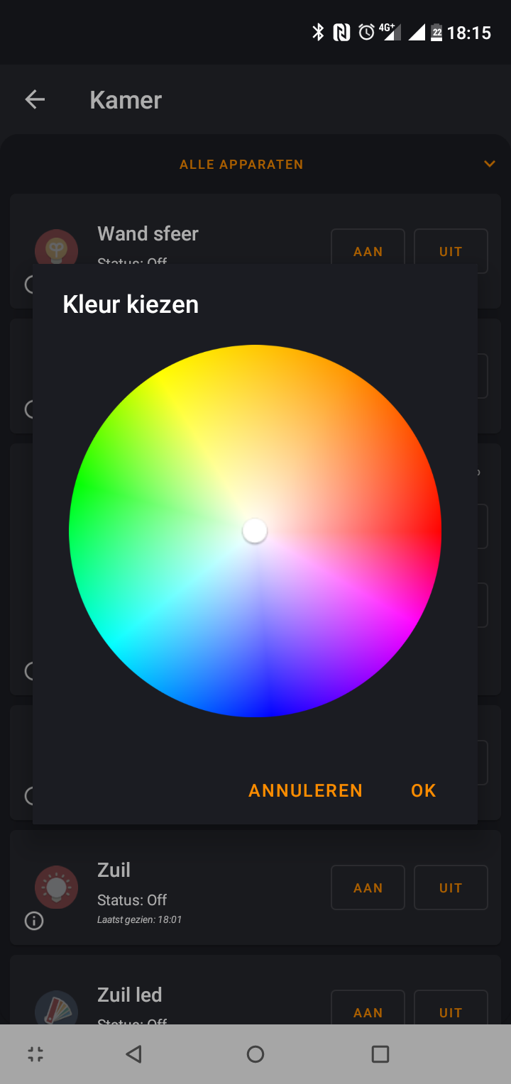

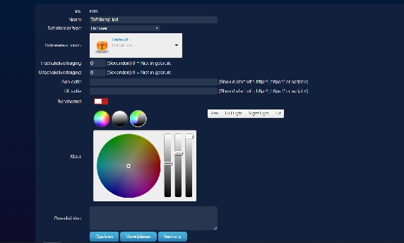

Hello .
i have 2 shelly rgbw2 everythig works fine in the browser but in the app i can't set the withe channel on or off
dimming isn't possible .
i'm missing the slider for the white channel .
someone else with this problem ?
see picture
Gerwin
