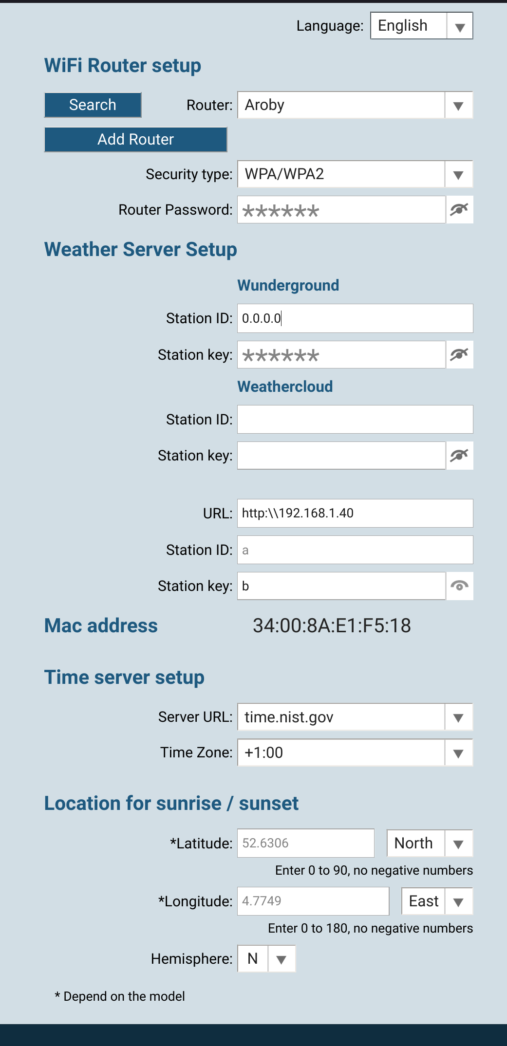

Yesterday I read about this very nice plugin and ordered the Garni 2055 Arcus. That arrived today.
Unfortunately it doesn't retrieve any values from the PWS.
Setup:
Domoticz Build 2020.2 Build 12392 on a PI (192.168.1.40)
Domoticz PWS Plugin - installed today
Garni 2055 Arcus
I've connected to WiFi of the Garni 2055 Arcus with my Android and configured to connect to my local WiFi. That workes fine. The PWS gets an IP address within my network. It synchronizes time with internet. Using a port scanner it was able to see the PWS is using port 5000.
The PWS configuration for the remote server is done on the same page (see attachment).
I configured at URL:
URL: http://192.168.1.40
Station ID: a
Station Key: b
Next thing was to install the plugin on the PI. That worked well without any errors.
Restarted Domoticz => Accept new hardware => all the PWS devices appeared. => but all the values are zero.
I tried to configure the remote server (Domoticz) on the PWS in the sections "Wunderground" and URL.
I tried http://192.168.1.40 (and accidentally as seen in the attachment http:\\192.168.1.40)
Within the log I do see a new error:
2020-09-25 13:18:29.937 Error: Error parsing http request.
What can be wrong here?
Setup:
Garni 2055 Arcus
Station ID: a
Station Key: b
- PWS webpage.png (203.84 KiB) Viewed 6670 times
Xorfor
Re: Python Plugin: PWS (Personal Weather Station)
You are not using the WS View app! Which tool are you using? I got some information from other users who used a Garni tool/app. Please read the README.md. I have no experience with that Garni app, but my understanding is that you have to enter only the ip address from your Domoticz server, so no 'http://'.

Hi Xorfor, I'm using the PWS webpage. WS View doesn't seem to connect to my PWS.
I just tried to enter the IP address of Domoticz without http..
Firmware Garni 2055: 1.07

Still no values.

Still no values.

I read the issue with user TheNetopyr. https://github.com/Xorfor/Domoticz-PWS-Plugin/issues/7
He writes about that "Garni 2055 does not allow to adjust the port to send the data, but by some iptables effort I redirected it internally".
Not quite sure how he did this.
I noticed via my NG firewall that the data from the PWS is indeed send to Domoticz port 80. But that port is in use by PI/Domoticz.
2020-09-26 10:38:30.995 (Arcus) onConnect Server=:80 -1-bind: Address already in use
2020-09-26 10:38:30.995 (Arcus) Name: 'Server', Transport: 'TCP/IP', Protocol: 'HTTP', Address: '', Port: '80', Baud: -1, Bytes: 0, Connected: False, Last Seen: 1970-01-01 01:00:00, Parent: 'None'
Not sure how to proceed.
Xorfor
Can you take a look at https://github.com/Xorfor/Domoticz-PWS-Plugin/issues/8.
User TheNetopyr fixed this issue for Garni with: iptables -t nat -A PREROUTING -s [IP of PWS] -p tcp --dport 80 -j DNAT --to-destination [IP of Domoticz]:5000
I only work with WS View/Easyweather, so hopefully this helps.
