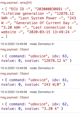

No solution for the HPE_HEADER error but found a way around it.
- made a page on the webserver on the Pi with the output of a simple-html-dom that scrapes the data from ECO and that does the trick for now.
- managed to get the last remaining node to work aswell.
-revplaced the 3 sensors for custom sensors.
Perhaps not a 100% solution but at least it works.

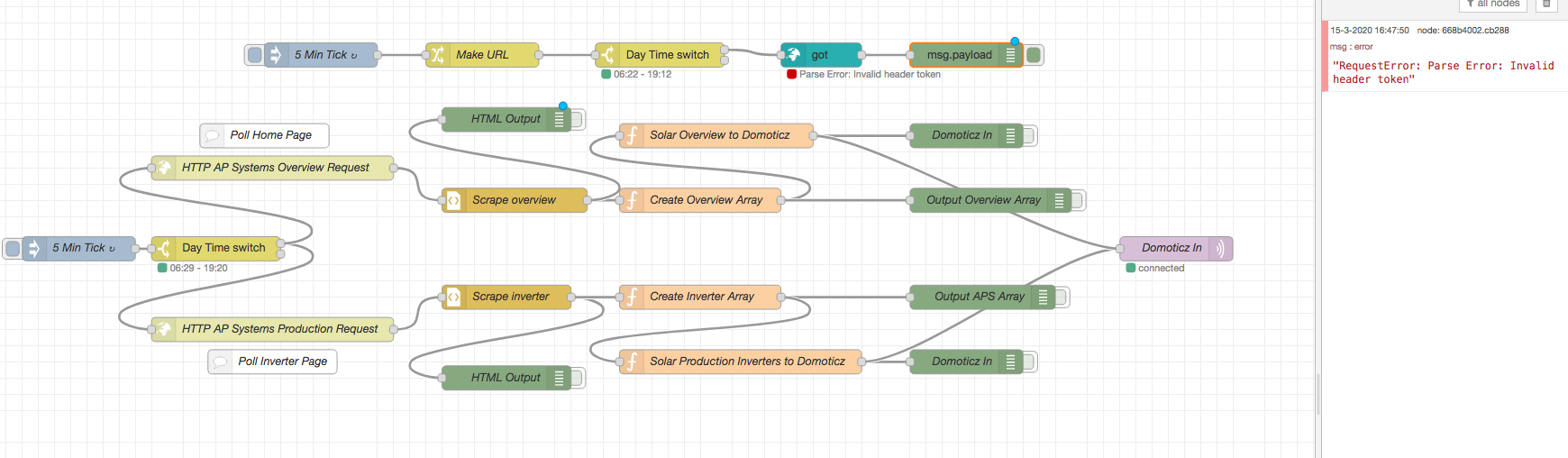

Now the general overview and Error: Parse Error: Invalid header token.
A search on Google turns out that this is caused by an incorrect / malformed server response, however the latter is not under our control.
It seems that the http parser in NodeJS 12 is more strict than in previous versions. If you google on this error message you will find of hits.
To make a long story short, we have 2 options.
OPTION 1
As you know, their are often more solutions (nodes) in Node Red for the same problem.
You can install another node from the Palette, called got. Search in Menu => Palette for "got".
You will also find "got sequenced". I tested them both and both works.
Install one of them (In the attached flow, I used got) and test the following flow:
[{"id":"f322cafd.82183","type":"inject","z":"d243b84a.4ac438","name":"5 Min Tick","topic":"","payload":"http://192.168.2.13/cgi-bin/home","payloadType":"str","repeat":"300","crontab":"","once":true,"onceDelay":"","x":130,"y":860,"wires":[["12abd3c5.d2a0f4"]]},{"id":"5a78701e.cab47","type":"got","z":"d243b84a.4ac438","name":"","timeout":30000,"x":750,"y":860,"wires":[["55e3d521.07fd0c"]]},{"id":"55e3d521.07fd0c","type":"debug","z":"d243b84a.4ac438","name":"","active":true,"tosidebar":true,"console":false,"tostatus":false,"complete":"false","x":930,"y":860,"wires":[]},{"id":"12abd3c5.d2a0f4","type":"change","z":"d243b84a.4ac438","name":"Make URL","rules":[{"t":"move","p":"payload","pt":"msg","to":"url","tot":"msg"}],"action":"","property":"","from":"","to":"","reg":false,"x":330,"y":860,"wires":[["ae1a8e8e.9e5cf"]]},{"id":"ae1a8e8e.9e5cf","type":"time-switch","z":"d243b84a.4ac438","name":"Day Time switch","lat":"52.179281","lon":"5.606528","startTime":"sunrise","endTime":"sunset","startOffset":"-30","endOffset":"+30","x":550,"y":860,"wires":[["5a78701e.cab47"],[]]}]
Could you test this flow? If this gives an output without errors, connect the html node, called "Scrape overview" and connect a debug node.

Macguyver
Posts: 14
Joined: Wednesday 26 February 2020 14:07
Target OS: OS X
Domoticz version: Latest
Location: Zeeland
Re: how to add APSystems ECU-3 solar inverter monitor
Post by Macguyver »
@Firewizard
More then willing to test.
see result below
gr,
Schermafbeelding 2020-03-15 om 16.47.53.png (158.09 KiB) Viewed 2598 times

I saw the result of the test with "got". It is exactly the same as, if you use the default HTTP node.
You can delete this node from your palette. I will do the same. It is not really useful and the default HTTP has more possibilities.
If you want you can try the downgrade, but is it possible to make an URL, where I can access that page.
The same way that @Benneton did. See earlier in this thread.
