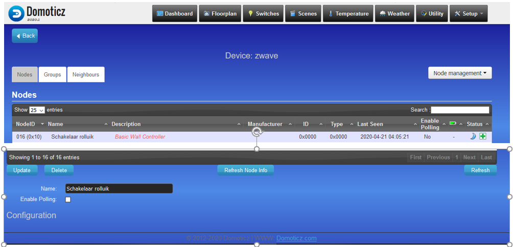

Hi All,
I received a Zwave basic wall controller (ordered here: https://www.robbshop.nl/wandzender-2v-z ... obb-smarrt, the manual can be found here: https://www.robbshop.nl/amfilerating/fi ... le_id/816/) a few days ago. After adding the device to my Zwave controller, Domoticz shows the device like this (Setup > Hardware > Setup Zwave controller): --> Description in image: Basic Wall Controller
No new devices are emerging (Setup> Devices). Normally it take some time to show the device properly, but in this case it's not showing the device properly after two days. Is this fixable for me or does this means that the device is not supported by Domoticz?
Thanks in advance!
Thanks in advance!

I added an another device to my Domoticz (FIBARO System FGRM223 Roller Shutter Controller 3+) and this went well (see pictures below). Does this mean that the 'Basic Wall Controller' will not be recognized by Domoticz?
--> Fibaro has been added correctly, the Basic Wall Controller is still not added correctly

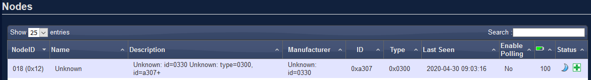

After contact with my reseller I excluded the device and included it again. Now it works
It's not working perfectly if you ask me. At the hardware tab the device is shown as: --> Unknown: id=0330 Unknown: type=0300, id=a307+
There are two Devices added and both are configured as a switch. Both switches stay at 'On', regardless of the buttons I press on the devices itself. However, with Dzvents it triggers the event depending on the button I press on the device. So it works for me now.

Now you could try to :Marcjeok wrote:After contact with my reseller I excluded the device and included it again. Now it works
Go to Hardware / Zwave settings / Select this node and press Refresh Node info to see if the text is now correct (vernieuw node info in Dutch), maybe the correct info is now displayed....

I did this yesterday and nothing seems to happen. Today I noticed that the configuration part was lost and when I pressed the buttons nothing happened any more. Somehow it lost his configuration. I excluded the node and included it again and now it's working again. Hope it stays like this...Snowtiger wrote: Thursday 30 April 2020 11:43 Now you could try to :
