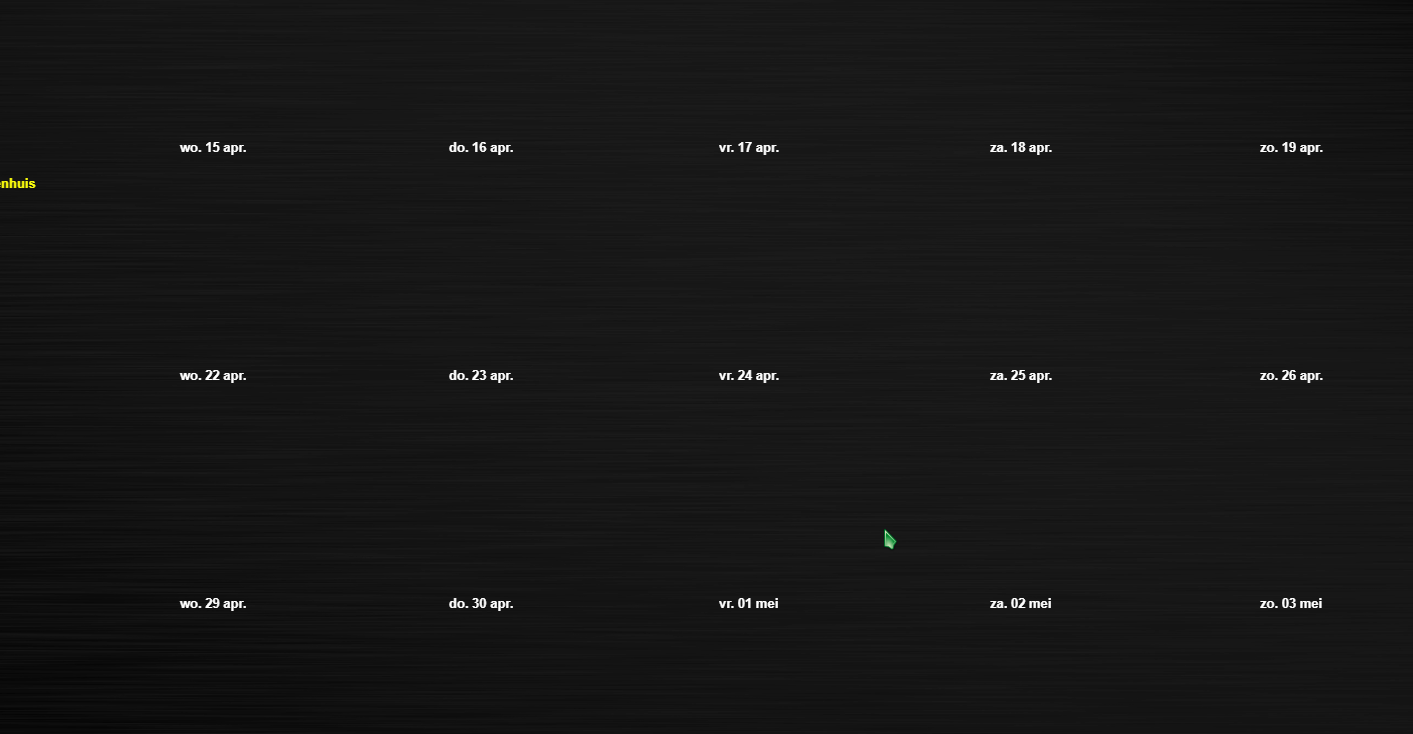

I have the calendar as a layout 2 and that works, but does not looks like the "example" page you show.
I have the calendar from my wife and me combined and that works also good.
But no headers above it only the dates ?
Just a small part of the screen :)

TankySpanky wrote: Sunday 12 April 2020 8:59 Hello,
ty in advance
Please could you show your calendar block config?
Also, are you using any other calendar blocks, if so, are they old or new calendar blocks?
What calendar ics are your adding to the icalurl? E.g. Gmail?
What happens when you try to access the icalurl directly in a browser, does it down the ics file?
TankySpanky
Posts: 43
Joined: Wednesday 06 February 2019 18:54
Location: Belgium
Re: Dashticz Calendar - Features, Fixes & Updates
Post by TankySpanky »
I have the "old" block on the front page
And made a 3rth page for the "new block"
var blocks = {}
blocks['gmail_calendars'] = {
type: 'calendar',
layout: 2,
icalurl: {
Personal: {
ics: 'https://calendar.google.com/calendar/ic ... /basic.ics',
color: 'yellow'
Business: {
color: 'pink'
holidayurl: 'https://www.calendarlabs.com/ical-calen ... lidays.ics',
maxitems: 100,
weeks: 5,
lastweek: true,
isoweek: false,
width: 12
And yes both gmail ICS files will be downloaded when i paste the urls in a browser window

TankySpanky wrote: Sunday 12 April 2020 9:40 Hello,
var blocks = {}
	type: 'calendar',
	layout: 2,
	icalurl: {
	   Personal: {
	      ics: 'https://calendar.google.com/calendar/ical/[email protected]/private-XXXXXXXXXXXXXX8ae9015e0e14/basic.ics',
	      color: 'yellow'
	   Business: {
	      ics: 'https://calendar.google.com/calendar/ical/[email protected]/private-XXXXXXXXXXXXXXX503831f725/basic.ics',
	      color: 'pink'
	holidayurl: 'https://www.calendarlabs.com/ical-calendar/ics/75/BE_Holidays.ics',
	maxitems: 100,
	weeks: 5,
	lastweek: true,
	isoweek: false,
	width: 12
I have just tried your block (above) with my calendar urls, and it works and displays correctly. I also have the old calendar block loaded fine next to it, so there are no issues with using both old and new. I suggest checking the following:
- See if there are any errors in DevTools (press F12 in Chrome and click on the console tab, any errors will be reported there).
- Check your Config.js file for any syntax issues. You can post a redacted version here if you want me to check it.

EDIT: the post below this one has the code for the calendar in it. After reading the last configuration part, my brain clicked:
last week: true -> false fixed the calendar items from 7-4 and showed 13-4 as the first one
adding another line in the config below/above " lastweek: false, " with the text: " icon: false, " fixed my icon question.
