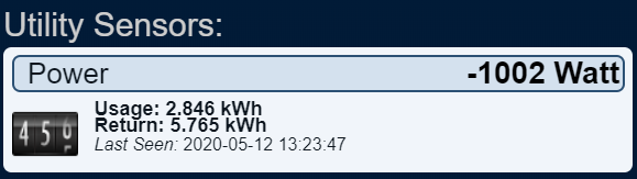

Is there currently a way to read utility sensor values from a Google Assistant command, like "what's my current energy usage"?
sensor example
sensor example

scrabble wrote: Tuesday 12 May 2020 13:25 Is there currently a way to read utility sensor values from a Google Assistant command, like "what's my current energy usage"?
Would be useful but dont find any trait that matches that in google assistant. We have to wait if google wants to add this
