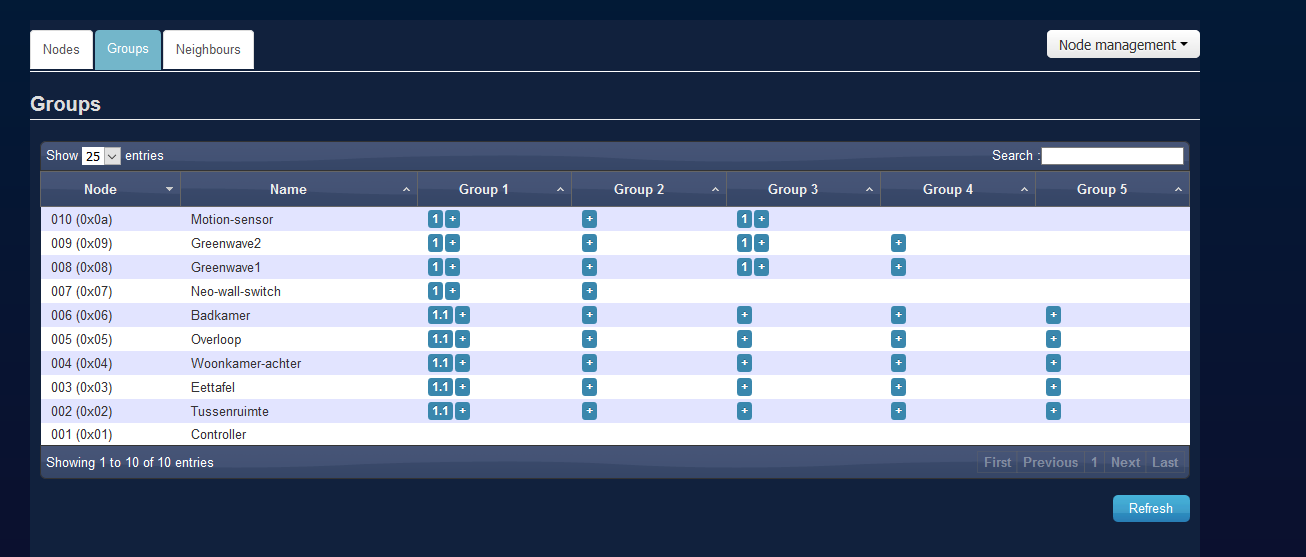

Piacco
- Posts: 81
- Joined: Friday 14 November 2014 9:33
Re: Is Z-wave multichannel supported ?
Here the same problem, i can't add node 2 to Group 1 of the motion sensor node 10, or is this not possible?
- Groups.PNG (36.85 KiB) Viewed 1532 times
