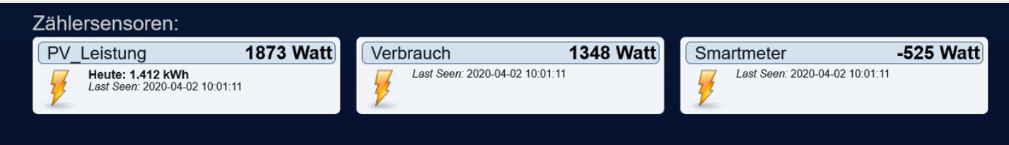

3) The screenshots to devices
This are my devices I added to domoticz with the commands, I wrote in my first post.
I wrote a lua script to get the values from the device and than update domoticz with this commands:
           commandArray[1] = {['UpdateDevice'] = idx_PV .. '|0|' .. PAC .. ';' .. DAY_ENERGY}  -- PV-Leistung
            commandArray[2] = {['UpdateDevice'] = idx_VERBRAUCH .. '|0|' .. EVUNetz }           -- Einspeisung/Bezug
            commandArray[3] = {['UpdateDevice'] = idx_EIGENVERBRAUCH .. '|0|' .. VERBRAUCH }    -- Akt. Verbrauch
            commandArray['Variable:nGrid'] = tostring(EVUNetz);                                                     -- for workaround
It's triggered with "Device". But I also tried triggered "All". That is not the problem. In my log I get:
2020-04-02 10:12:30.597 Status: EventSystem: Script event triggered: FroniusAdapter
FroniusAdapter is the name of the Script. I think this is the hint, that the script was done sucessfull
The values in the device tab are updated in a correct manner :-)

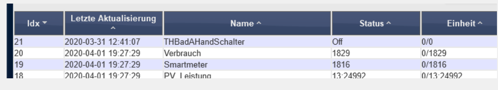

The value I want to trigger is 'Smartmeter'. It's listed in the list of devices at the domoticz programming site:
but the scrip will not be triggered. Also it is not usable in a normal lua script with:
    local meter = otherdevices['Smartmeter']

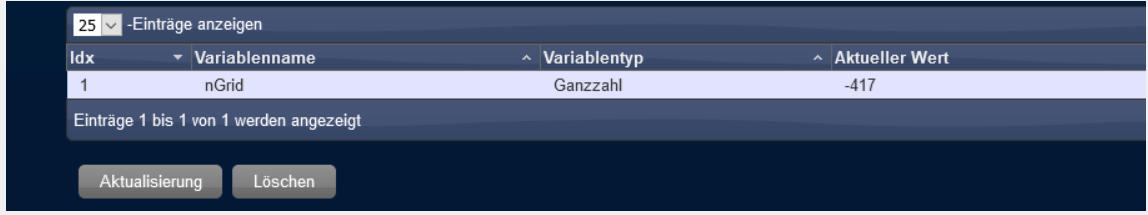

the userVariable is set in Settings-Option-User variable:
So I hope you now have enougth information to help me. If not, as a different way, we can make a direct connection (mail,whatsapp, teamviewer,..), if you want. And than post the result here for others.
