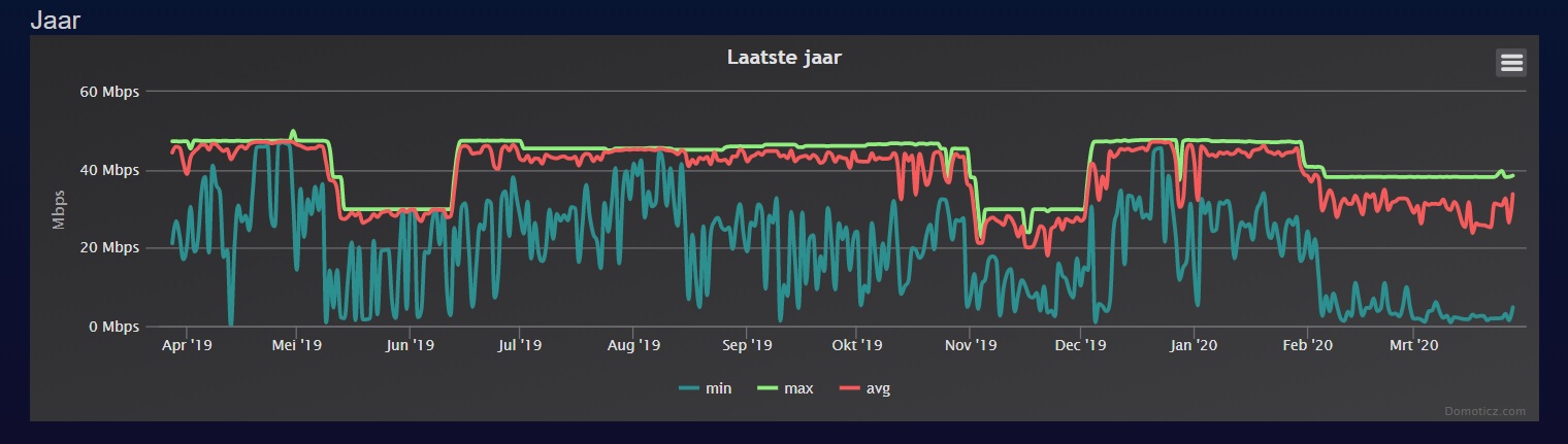

speedtest trend.jpg (121.03 KiB) Viewed 18694 times

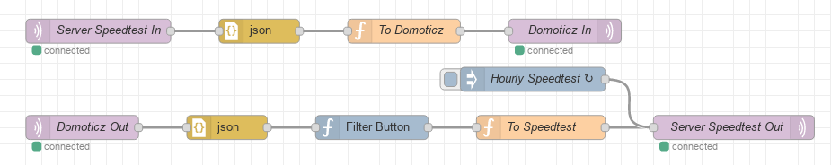

The next step is to prepare the flow in Node Red.
The flow in Node Red consist of two parts.
1. The incoming flow from your device, that runs speedtest, to Domoticz (Upper part)
2. The outgoing flow from Domoticz and Node Red to activate the speedtest-cli command (Lower part)
If you do not want to use the push button in Domoticz, you do not need the Lower part of the flow.
However in this case, you have to setup a cronjob in the device, which has speedtest-cli installed
Screenshot_speedtest flow1.png (27.93 KiB) Viewed 18640 times

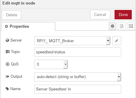

1. Incoming flow
The first node is a MQTT input node. You have to insert the topic, that you use in the mosquitto_publish command on the device, that has
speedtest-cli installed. In this case speedtest/status.

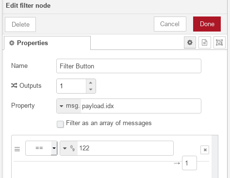

If you have decided to include the push button in Domoticz, you need the lower part of the flow as well.
The first node is the default MQTT Output node, which is subscribed to domoticz/out, followed by the default JSON node.
The next node is anon-default node, that has to be installed from the palette.
This node filters the idx of the push button in Node Red. So check that idx number.
Install this node: node-red-contrib-filter.
It is configured as follows:
Screenshot_speedtest flow3.png (16.53 KiB) Viewed 18638 times
Replace the idx number with your idx.

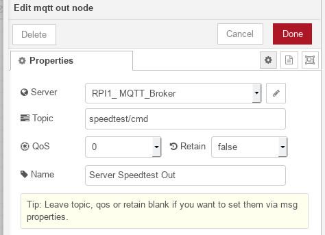

The next node is a function node to send the correct data to the device, that has mqtt-launcher and speedtest-cli installed.
The contents is as follows:
if (msg.payload.nvalue === 1) {
    msg.payload = "on";
return msg;
This payload is send to a MQTT Output node, which is configured as follows:
Screenshot_speedtest flow4.png (21.82 KiB) Viewed 18638 times
This flow sends the push button command to your device, that has speedtest-cli installed.

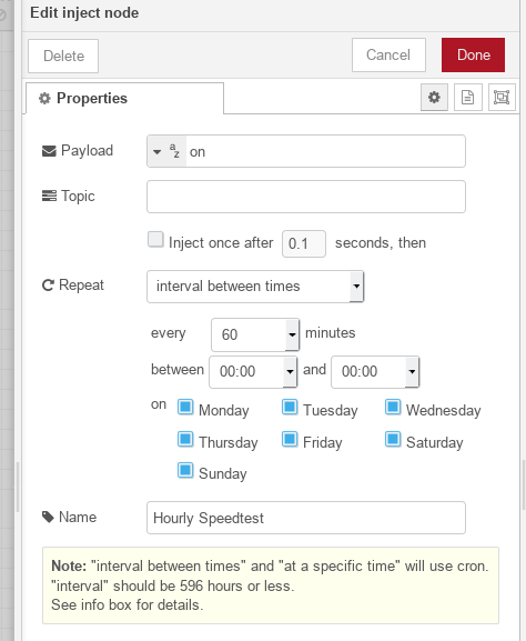

The regular timing is done by an inject node that injects the correct payload to the same MQTT Output node.
Screenshot_speedtest flow5.png (33 KiB) Viewed 18638 times
Below you will find the complete flows:
[{"id":"8395ba46.a4eb1","type":"mqtt in","z":"ab5ccf37.8faeb8","name":"Server Speedtest In","topic":"speedtest/status","qos":"0","datatype":"auto","broker":"f9f13036.e28b58","x":190,"y":100,"wires":[["2eb9c765.43fa"]]},{"id":"2eb9c765.43fa","type":"json","z":"ab5ccf37.8faeb8","name":"","property":"payload","action":"","pretty":false,"x":390,"y":100,"wires":[["813c9c3b.7fb578"]]},{"id":"813c9c3b.7fb578","type":"function","z":"ab5ccf37.8faeb8","name":"To Domoticz","func":"var msg1 ={};\nvar msg2 ={};\nvar msg3 ={};\nmsg1.payload = {\"command\":\"udevice\",\"idx\":119,\"nvalue\":0,\"svalue\":msg.payload.ping.latency.toString()};\nmsg2.payload = {\"command\":\"udevice\",\"idx\":120,\"nvalue\":0,\"svalue\":(parseFloat((msg.payload.download.bytes*8/msg.payload.download.elapsed)/1000).toFixed(3)).toString()};\nmsg3.payload = {\"command\":\"udevice\",\"idx\":121,\"nvalue\":0,\"svalue\":(parseFloat((msg.payload.upload.bytes*8/msg.payload.upload.elapsed)/1000).toFixed(3)).toString()};\nreturn [[msg1,msg2,msg3]];","outputs":1,"noerr":0,"x":570,"y":100,"wires":[["ed6c10df.d23618"]]},{"id":"ed6c10df.d23618","type":"mqtt out","z":"ab5ccf37.8faeb8","name":"Domoticz In","topic":"domoticz/in","qos":"2","retain":"false","broker":"f9f13036.e28b58","x":770,"y":100,"wires":[]},{"id":"ec89ae7.ce185d","type":"mqtt in","z":"ab5ccf37.8faeb8","name":"Domoticz Out","topic":"domoticz/out","qos":"2","datatype":"auto","broker":"f9f13036.e28b58","x":170,"y":220,"wires":[["8f15b75e.0a94e"]]},{"id":"451753bf.8d4d14","type":"filter","z":"ab5ccf37.8faeb8","name":"Filter Button","property":"payload.idx","propertyType":"msg","asArray":false,"itemProperty":"","itemPropertyType":"item","rules":[{"t":"eq","v":"122","vt":"num","output":1}],"checkall":"true","outputs":1,"x":530,"y":220,"wires":[["d6e722d6.125e5"]]},{"id":"8f15b75e.0a94e","type":"json","z":"ab5ccf37.8faeb8","name":"","property":"payload","action":"","pretty":false,"x":350,"y":220,"wires":[["451753bf.8d4d14"]]},{"id":"d6e722d6.125e5","type":"function","z":"ab5ccf37.8faeb8","name":"To Speedtest","func":"if (msg.payload.nvalue === 1) {\n    msg.payload = \"on\";\n}\nreturn msg;","outputs":1,"noerr":0,"x":740,"y":220,"wires":[["64d59364.f1eb74"]]},{"id":"64d59364.f1eb74","type":"mqtt out","z":"ab5ccf37.8faeb8","name":"Server Speedtest Out","topic":"speedtest/cmd","qos":"0","retain":"false","broker":"f9f13036.e28b58","x":980,"y":220,"wires":[]},{"id":"681cf784.d0b4d8","type":"inject","z":"ab5ccf37.8faeb8","name":"Hourly Speedtest ","topic":"","payload":"on","payloadType":"str","repeat":"","crontab":"0 0-23 * * *","once":false,"onceDelay":0.1,"x":730,"y":160,"wires":[["64d59364.f1eb74"]]},{"id":"f9f13036.e28b58","type":"mqtt-broker","z":null,"name":"RPI1_ MQTT_Broker","broker":"192.168.10.51","port":"1883","clientid":"","usetls":false,"compatmode":true,"keepalive":"60","cleansession":true,"birthTopic":"","birthQos":"0","birthRetain":"false","birthPayload":"","closeTopic":"","closeQos":"0","closePayload":"","willTopic":"","willQos":"0","willPayload":""}]

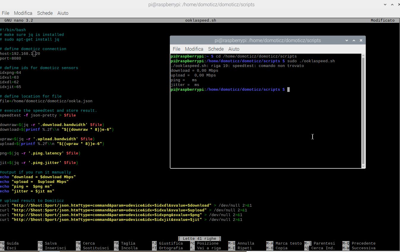

Guys but something happened
I notice that it hasn't worked for a few months
If I try from the terminal and I start the script from this error
pi@raspberrypi:/home/domoticz/domoticz/scripts $ sudo ./ooklaspeed.sh
./ooklaspeed.sh: riga 19: speedtest: comando non trovato
download = 0,00 Mbps
upload = 0,00 Mbps
ping = ms
jitter = ms
FireWizard
Posts: 1980
Location: Voorthuizen (NL)
Re: Ookla Speedtest CLI integration
Post by FireWizard »
Hello @SavioThecnic
From time to time Ookla Speedtest requires that you accept their license.
You will not see this, until you open a terminal and activate the speedtest-cli manually..
However it is indicated in Domoticz with a red bar above your widget, that it has exceed the maximum time for that sensor.
In the first version of the script, the first part of the command was as follows:
/usr/bin/speedtest --format=json
Currently I use:
/usr/bin/speedtest --accept-gdpr --format=json
This works fine for me, so far.
But you may want to add --accept-licence as well. See the @grutter post.
You can test from the command line in a terminal.
