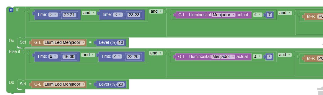

I'm working to improve my blockly's scripts and one of theaseone's is not working.
The light works good, and turn on or off depends the conditions, but doesn't work the timer. I want to dimmer the light depending of the hours.
any idea? thanks!!!!

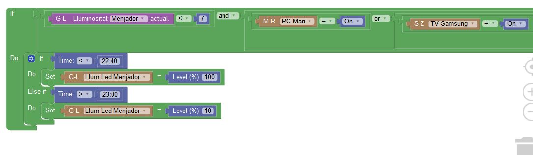

you will need a time trigger for the Do's to be executed.
Right now your triggers are light level, the TV and the PC. if either of them change state, the function will check the time and act accordingly.
Time itself is not a trigger in your blocky at the moment; you will need to include that in the IF statement.
A good example:
https://www.domoticz.com/forum/viewtopi ... 911#p15911
