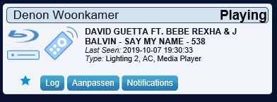

This plugin works only for 40% at the moment.
I have bought two HEOS by Denon speakers last week. You can add the hardware and get one new "Media Player" item in the switch section.
When using the remote, the following buttons do not work:
- Favorites
- Browse
- Shuffle
- NowPlaying
- Repeat
You get the following error for every coresponding button:
 2019-10-07 19:22:11.086 Error: HEOS by DENON: Command: 'NowPlaying'. Unknown command.
Buttons that do work on the remote:
- Volume Up
- Volume Down
- Mute
- Stop
- Pause
- Play
- Play Next
- Play Previous
The status from the player is not getting updated to the "devices status" from domoticz untill a reset takes place for example when you edit the name of a switch and save it. Here you can see what I meen:
The Player with the actual "Playing" status:
At the same time in the "Device Current States" in the Event section:
After saving a switch the status gets updated:
Also sending Commands to the player like "Stop" or "Mute" in LUA aren't working.
commandArray['Denon Woonkamer'] = 'Stop'
So we can't do anything with this to automate some things.
