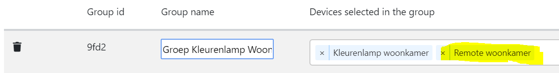

I did pair with zigate and the bulbs.. I want to include them in the groups too, just like i can with the 5 button remote. Reason is that the plugin detects activity and the devices dissapear in this view:
I did this with the five button remotes (see image down 'Remote woonkamer') and after adding them to the groups, they don't appear as unseeen anymore:
And in case someone wants just to use the remote for controlling something else beside zigbee bulbs, it would be handy to have the remote together with zigate in the group to receive the button events in domoticz.

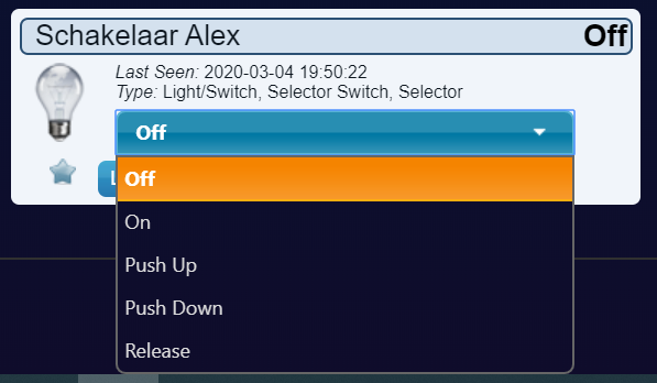

I know the 5-button remote can be added to the group. You can put it in a group together with ZiGate to just catch the push-events.
My question actualy is: Why this can be done with the 5-button remote and not with the 2 button remote. Is there a reason not to allow this? (This thread gave me the idea that this kind of remote messed things up when added to a group)
This is the 2 button remote device in domoticz:
There are these 5 different events available that can be catched if the remote is allowed with ZiGate in a group. At least i would think so, because with the 5-button this could be accomplished.

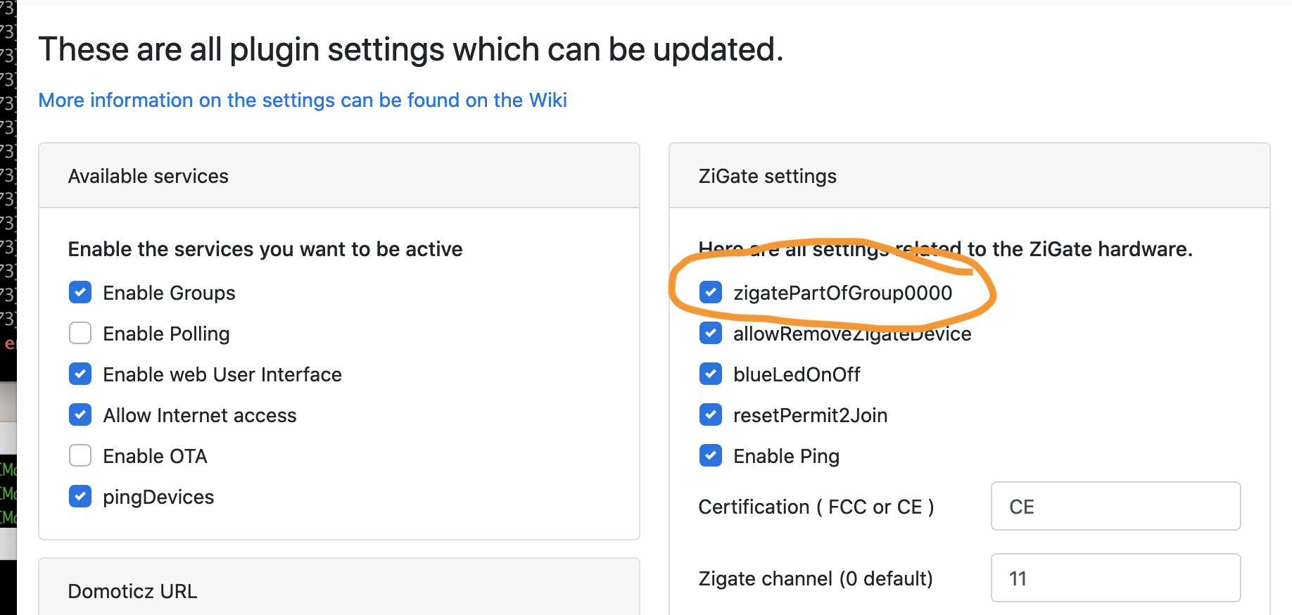

Was not able to gho to ikea and pruchase , but can you do a test
(1) switch to plugin beta branche if not yet done ( git checkout beta )
(2) get the latest version of the plugin beta ( git pull)
(3) Start the plugin, wait for 1 minute and then go to the WebAdmin -> Settings -> Advanced and enable zigatePartOfGroup0000 like here after
Screenshot 2020-03-15 at 12.19.04.png (208.23 KiB) Viewed 3451 times
(4) Restart the Plugin
(5) Pair the Remote Switch with Zigate
and try to use it , in order to see if the widget is updated ?
Would appreciate to get any logs ( for that enable debugInputs )
