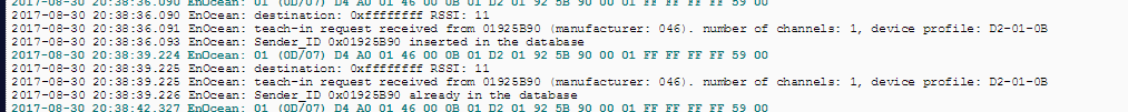

2/ Here is the log for smart plug :
2016-12-31 13:28:48.499 EnOcean: 01 (0D/07) D4 A0 01 47 81 0B 01 D2 01 85 B0 76 88 01 FF FF FF FF 5F 00
2016-12-31 13:28:48.500 EnOcean: destination: 0xffffffff RSSI: 5
2016-12-31 13:28:48.500 EnOcean: teach-in request received from 0185B076 (manufacturer: 147). number of channels: 1, device profile: D2-01-0B
2016-12-31 13:28:48.503 EnOcean: Sender_ID 0x0185B076 inserted in the database
I did a "Learn Light/switch" in "Switches" tab
A windows appeared and ask to push btn on the plug
i gave a name to the new device (odd it is discover like a blind)

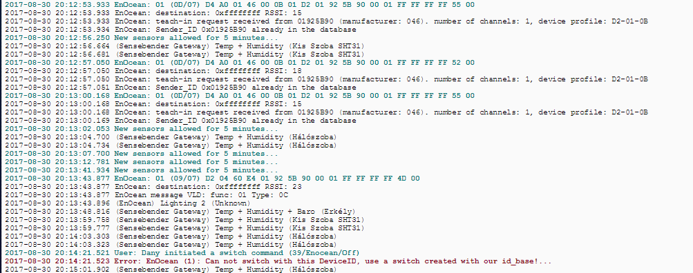

Now when i click on the device in domoticz this message appears
"Error sending switch command, check device/hardware !"

ok I find a solution, I needed to create a virtual enocean device to command this plug :)
