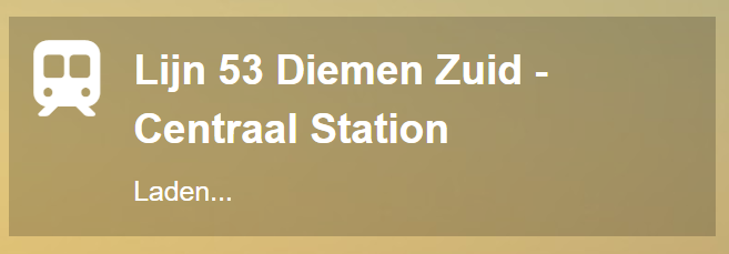

If not posted in the right topic, a request to the moderator to show me in the right direction?
Rediscovering Dashticz and setting up a new dashboard for the last couple of days. Using 3.10.1 beta.
Having problems however with the public tranport block. I am wrestling with it for a few days now but cannot get it solved.
Is there a problem perhaps with 'ovapi'?
I am getting "loading' result;
Lijn 53.png (34.8 KiB) Viewed 3273 times
blocks['ovapi'] = {
tpc: '09542',
title: 'Lijn 53 Diemen Zuid - Centraal Station',
show_lastupdate: true,
provider: 'ovapi',
show_via: true,
icon: 'fas fa-subway',
interval: '120',
newindow: '1',
results: 5,
width: 6
tpc code is for GVB lines 50 and 53 at station 'Diemen Zuid'
When i load 'treinen' for station Diemen Zuid it works perfectly.
Is this because ovapi is not working correct or am i doing something wrong?
