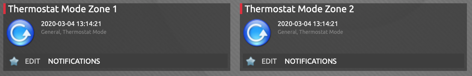

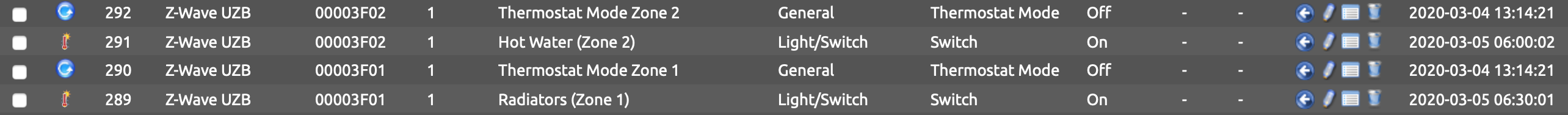

I am using the SSR302 on Domoticz running on a Raspberry Pi and it works flawlessly. Including the SSR302 was easy and it appears as 4 devices in Domoticz. 2 x Thermostat Mode devices (Zone 1 and 2) and 2 x Switches (Zone 1 and Zone 2).
Controlling the SSR302 from Domoticz is really easy just turn on/off the Switches for ether Zone 1 or Zone. When using it like this the SSR302 will NOT enter failsafe mode. This is great as usually the device needs to be re-confirmed with repeated ON signals otherwise. So no need to use delays, scripts or any other logic control. So it possible to use Domoticz timers straight from the switch for the zone 1 or 2.
Controlling the SSR302 from Domoticz using the the Thermostat modes as two options for each zone, OFF and HEAT. Setting to heat will also switch on the zone however as this is a thermostat mode operation if no further request for HEAT is made the unit enter failsafe mode for that zone and switches of that zone.
One final point the SSR302 doesn't report back the Zone on/off status if manually switched on at the devices by pressing the green and red buttons. Do fix this just make sure you "Enable Polling" in Domoticz for the device and this will fix that issue.
