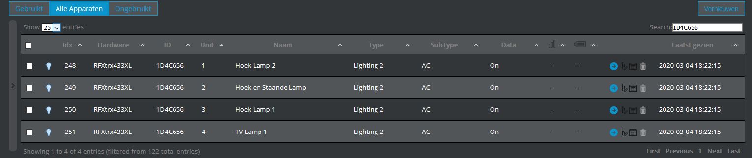

I have an RFXtrx433XL USB connected to Domoticz (RPi with Raspian Buster).
to control 3 KAKU APC3-2300R receivers with a KAKU remote type AYCT-102
On the devices tab in Domoticz I learned the first 4 buttons of the AYCT-102 remote:
3 learned remote buttons created 3 Switches
The 3 created Switches respond as expected in Domoticz.
The 4th button is also learned as a Switch, The Remote button and Switch are used to control a wifi Lamp
All 4 Switches go ON/OFF in Domoticz when pressing the physical remote buttons as expected.
However, when I press the Group ON/OFF buttons (the 5th row buttons) of the AYCT-102 remote,
all 3 receivers (and connected lights) go ON/OFF, but in Domoticz only 1 of the 4 Switches is turned ON/OFF. The other 3 Switches are not responding to the remotes Group button.
Also when I try to learn the Group button of the AYCT-102 remote, I get the message that this button is already in use by one of the 4 Switches.
