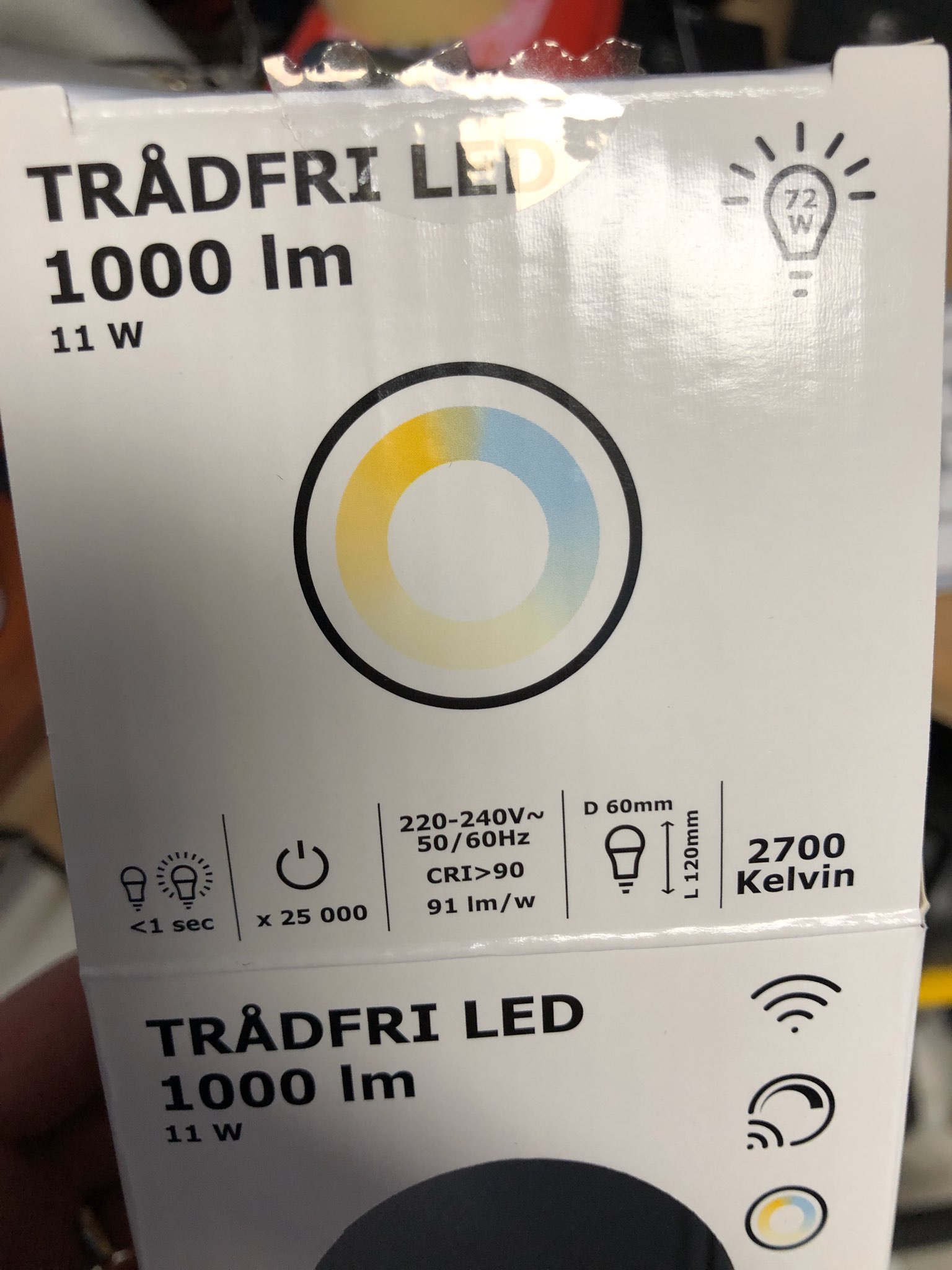

Re: Ikea tradfri bulb: adjusting white color in Zigate
Hi Pipiche,
With this Ikea bulb the white balance is also changeable.
See the yellow/white/blue logo on the box.
Could you please let me know on which version of the plugin you are ?TonkaNL wrote: Saturday 29 February 2020 12:20 Hi Pipiche,
And indeed the 'TRADFRI bulb E27 WS opal 1000lm' should be seen as a WW color
In case you are on the latest version at least 4.7.004 or above this should work, and if it is not , please provide the log during the pairing process
The version of the plugin is 4.7.3
Pairing log is underway.
Please update the plugin, you need at least 4.7.004
Succes!! Tnx.
