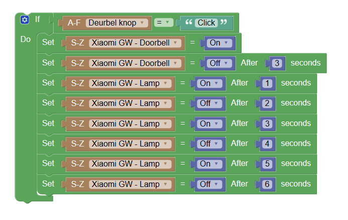

I'm fairly new to domotics and am trying to get an Aqara simple switch button to trigger a simple event. The event (the Do) is tested and working (with dummy button). Thing is, somehow the blocky setup as seen in the screenshot doesnt seem to trigger. What strikes me too is tha fact that mine "Click" blocky has a green color all screenshots online show blue.
Thank yoy for your help!

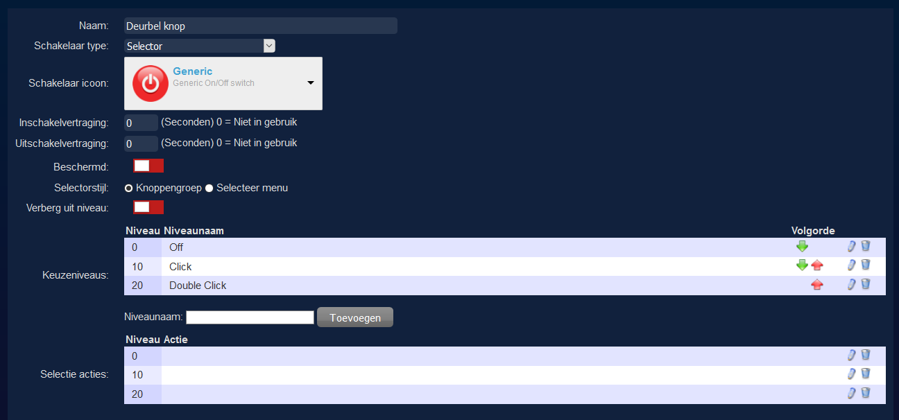

Think you need to test for the value 10 in stead of the word "Click".
Jos

Hi Jos, Thanks for your quick reply, i think the problem is somewhere else. I wont seem to be able to send commands back to de xiaomi gateway all the sudden. That thing is buggy :/ ... Well, thanks anyway!

Apperantly it al works now after rebooting the hub... Topic can be closed...
