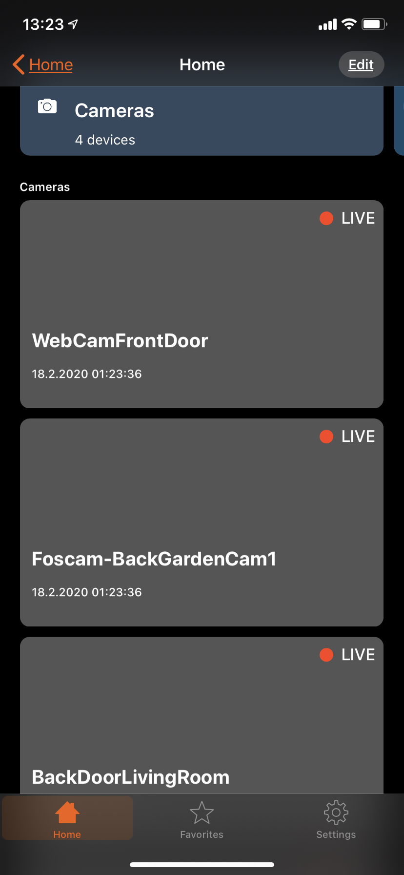

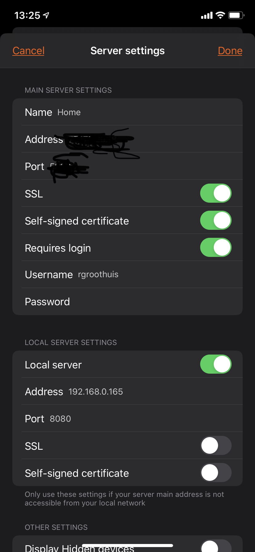

Where can you change the configuration to use "basic-auth"? I only have SSL or not, see screenshot.
And my camera's in Pilot are not showing any video, the red light is blinking to indicate there is live video, the clock is ticking but there is no video, see also screenshot.
Any suggestion on how to solve this?

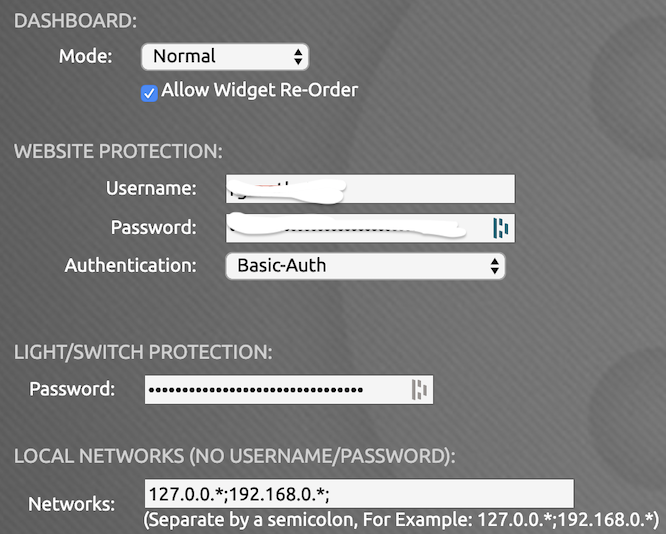

rgroothuis wrote: Tuesday 18 February 2020 13:28 Where can you change the configuration to use "basic-auth"? I only have SSL or not, see screenshot.
You have to change it in the domoticz settings itself (in the domoticz web interface). You can choose between "login page" and "basic-auth", seems like camera only works when selecting basic-auth.
It's not ideal since you'll lose the login page when going to the web interface of domoticz, but as of today, it's the only solution to bypass to weird bug... Still looking for a fix, still haven't found one. :(

patoo77 wrote: Tuesday 18 February 2020 13:58
Setting was found, changed it (see screenshot) but camera's still on black in the Pilot app on the iPhone :-(
