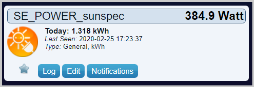

I have been playing with your modified script and changed it a little to combine the W and WH values into one Domoticz Instant&Counter device instead of having them in separate devices.
https://www.domoticz.com/wiki/Domoticz_ ... counter.29
</jos>

jvdz
Posts: 2329
Domoticz version: 4.107
Re: Python SolarEdge modbus script via lan
Post by jvdz »
Thanks for sharing your script!
These are the modifications I made in case somebody is interested:
At the top define a global variable for W to save the value for later use. Add the second line under the "ATTEMPTS = 1" line:
ATTEMPTS = 1
SAVE_W = 0
Update for the domo function:
#call url and write message
def domo(domoname,domovalue):
    global SAVE_W
    if domoname in DOMO_DEF:
        domoidx = DOMO_DEF[domoname]
        if domoidx != '0':
            if domoname == "W":
               SAVE_W = domovalue     #Save Wattage
            elif domoname == "WH":
               urlmessage = 'http://'+domoip+':'+domoport+'/json.htm?type=command&param=udevice&idx='+str(DOMO_DEF["WH"])+'&svalue='+str(SAVE_W)+';'+str(domovalue)
               r=requests.get(urlmessage)
            else:
               urlmessage = 'http://'+domoip+':'+domoport+'/json.htm?type=command&param=udevice&idx='+str(domoidx)+'&svalue='+str(domovalue)
    else:
        return True
    return True
Jos
