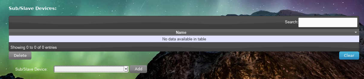

Do you mean this:
If you click on the arrow, right on the field Sub/Slave Device,you should see all Masters.
I have seen sometimes in the past, that the drop down list was empty. A screen refresh (F5) mostly solved that problem.
Have you tried that?
Do you mean this:

It's when you are creating a new switch 'manually' and you select the slave radio button. Then from the drop down that appears titled 'Device:' there is nothing to select.
The screen you have shown is to select a slave device for a master (not too sure of the difference between the two approaches though).

OK, yes I see it now.
The same here.
The same here.
