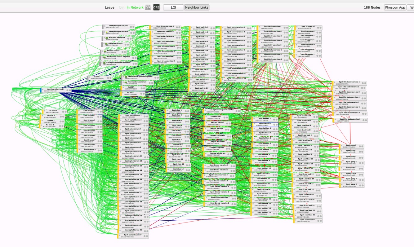

Thorgal789
- Posts: 881
- Joined: Wednesday 15 August 2018 14:38
- Target OS: -
Re: Which Zigbee controller
"rock solid" ?
Here a deconz network with 188 nodes.
Regular update too, 1 beta and 1 stable by month, but ok an incredible leak of documentation, and no official list for supported device.
It use too a server, so all other app can connect to it in same time, but REST server, not mqtt, so all native, no need to add a MQTT server, can use a simple browser, or curl command.
