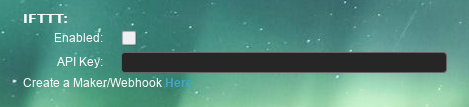

Next step is to go to Domoticz.
Go to Setup > Settings > Notifications
Somewhere in the middle left you will find:
Tick the box "Enabled"
Insert (Copy/Paste) your API Key
And then Click on "Here" in "Create a Maker/Webhook Here)
This will take you to: https://ifttt.com/maker_webhooks
From there you can create a webhook to activate a switch, which on its turn will switch the lamp(s).

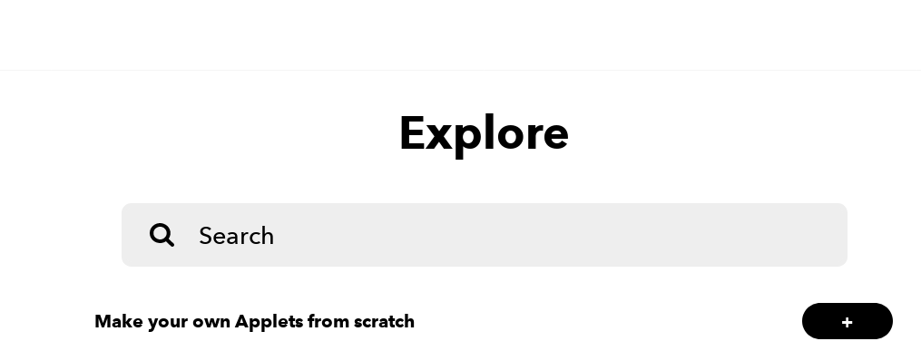

I follow you, but there is a problem. Where do I make the applet?
IN IFTTT I only found this:
And I searched another applet called: Custom Google Home Response by Grahamwalter. But it doesn't let me enter 'Language' or 'Make a web request'.
Where do I do this?
FireWizard
Posts: 1967
Location: Voorthuizen (NL)
Re: IFTTT to control Domoticz
Post by FireWizard »
In the top right you find "Explore", Click on it.
Then you will see "Make your own Applets from scratch and a +.
Click on the +
Click again on the + between "If" and "This"
Use "Google Assistant". Click on it and follow the Wizard.
(I do not remember this and I believe it has evaluated since September 2018, when I used it for the last time)
You have something to explore and to try.

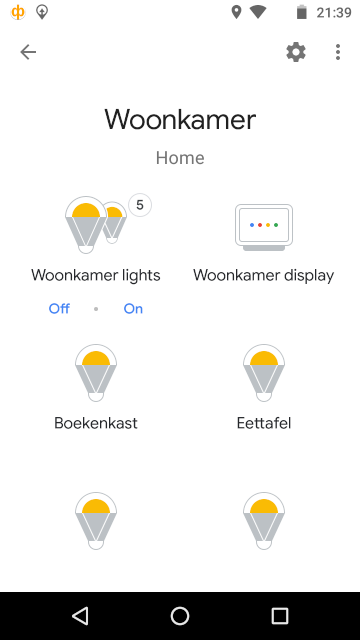

I assume you don't have added the lights in your Google Home app? Do you have any Google Nest device, such as the Speaker or Hub?
If so, they should be added in your Google Home app.
You can see it in the app.
Probably "Lamps" or "Lights" are "Reserved" words for the Google Assistant and the Assistant will try the find them.
If he/she cannot find it, he/she will tell you, that they cannot be found.
If you think, this is the case, try to avoid the words "Lamp" and "Lights".

I do have a Google Home Mini.
And I'm familiar with the devices you can link to Google Home.
Those words might be reserved, because I cant make use 'lights' or 'lamp'.
Switch does seem to work.
